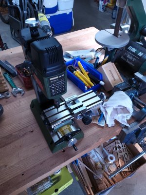

OK...so when thinking about a drill press, you mentioned one thing that makes a LOT of difference when considering a drill press for your shop. That was your need to be able to use it for woodworking along with model building. What kind of woodworking? Just small stuff? Or desks, kitchen cabinets, furniture? If you are serious about woodworking, then at a minimum, a desktop model with a 3/8" or 1/2" chuck might be needed. Otherwise, for bigger stuff, a floor standing model would be best. Then, when it comes to ship modelling, a mini drill press might better suit your needs. Mini drill presses or mini mills have a limited capability when considering woodworking. But the mini mill offers so much as far as model making is concerned. On the full sized drill presses, you can add sanding drums and chisel bits for cutting square holes as well as polishing wheels for metal work. And you can always chuck up a smaller chuck for the smaller drill bits. And lastly, budget and space. Both considerations that need to be taken into account. I have a floor-standing Delta, a Proxxon Mini Mill, a drill press stand for an Arrowmax drill, a Foredom type rotary tool and a whole host of hand held drill motors. I had a counter top drill press but passed it on to my son when I got the floor model. It worked well but wasn't big enough for some of the wood and metal working I do. And don't forget, when it come to drilling metal, a drill press is a must. Hope you find what best suits you and your needs. Maybe start small then work up?dp1.jpgDP2.jpgDP3.jpg
