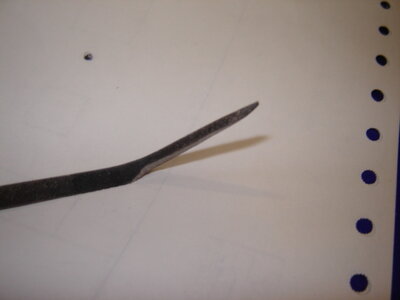

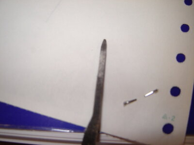

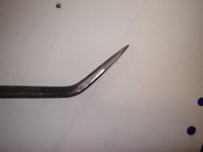

It took maybe 30 mins. to do this (maybe more, I lose track of time when I'm doing this kind of stuff :) )
I heated, bent, and quenched in water in one go. because I bent them in one small spot there was no distortion of the teeth although I can see that happening if you tried to curve a file. Then I ground off the two sides leaving teeth on the face and smooth sides. If I grind the teeth off the side of a file leaving(in this case) an .073" wide file with a toothless edge it cuts a very clean slot that is very close to .073"(the width of my ledges). Just don't overheat the file when grinding it.
Anyway it was a success. I have done this before but I've never bent a file before. I've even used old dull files sharpened in phosphoric acid and they work a treat. I've got 50 years of old files(some of my dad's too)so I can custom grind one for each need. One of the three sides of a triangle file is usually pretty good, especially close to the tip.
The pictures are all of the same file

The dogleg just seems to change the cutting angle. A rounded one, like rifflers, make it difficult for me to cut a flat bottomed notch. because the angle keeps changing as the rounded surface travels across the work. I always end up with a notch that's rounded opposite to the tool. If you follow me.:)
