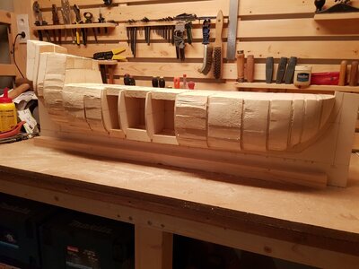

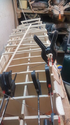

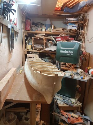

With 6 feet length it will be a very long hull, so you will need for stability reasons also stiffeners between the bulkheads / frames
So maybe it will be the best to fill the space between the bulkheads with filling wood. With this you have the complete surface for fixing the planking

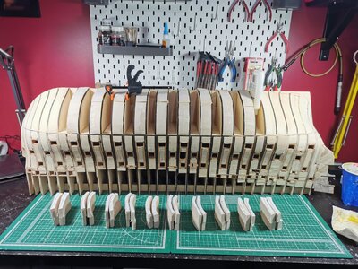

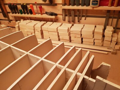

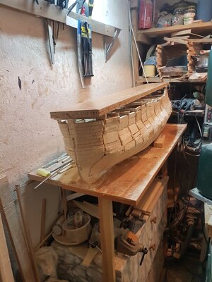

like @OlegM

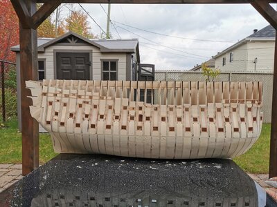

or @Herman

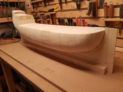

or @Mirek
all are getting with this technique a wonderfull result
