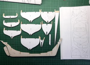

I got a Black and Decker on sale years ago. Variable speed, tilting table. Works fine. I find it hard to believe there’s that much difference in scroll saws. Of course, I could be wrong but mine did the job in cutting frame sections (futtocks?) with precision.
