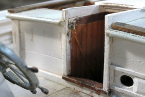

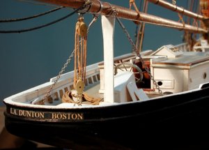

For the hull it depends if you want the Bluenose 11 squeaky clean or the fishing boat. See Tom Lauria's youtube channel regarding suggestion of scale by muting colours. As a marine artist it's used instinctively for aeriel perspective, (I must admit, it didn't occur to me to try it on a model) That and weathering has produced the best fishing schooner (Dunton, but the same applies) I've seen. Tom uses a flat black with a little white to produce a dark grey, the mix will vary with scale from almost black to a more obvious grey (Tom explains this well) I use Humbrol (UK) spirit based paints, you can get a beautiful finish with a flat nylon (or any watercolour) brush. Saves me juggling with my airbrushes. I usually build at 1:48 and 'til now have been using unmixed black. I'll be experimenting with my next build. My first kit was AL's Jolie Brise. The example is shown in a high gloss black (indeed that is the colour of the modern charter cutter. I could have 'satinised' the finish but I wanted the old pilot boat look) The modern Bluenose is the same. So really, are you building Bluenose 1 or 2? My phone camera doesn't really capture it, but the weathering is serious food for thought. I'm re-thinking my entire approach. Tom's builds look like boats I remember being sick on!!!!
