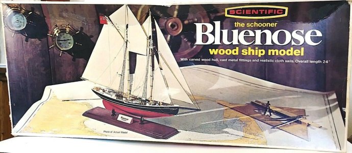

Hi! I'm new here and had this Scientific Kit No. 164 - Bluenose sitting around for the last 32 years or so still yet unfinished. As far as I know its in the scale of 1:72.
Alas, the instructions are very vague and I had no idea how to start rigging it plus it's forward mast had warped with age.
But now there is internet plus the AI GPT-4o mini which has been a great help in answering my ship building questions. I'm now retired and have the time to finish it plus physical limitations have made standing at my two train layouts (1:160 and 1:78 scales) pretty difficult lately. Therefore I enjoy sitting in the dining room (where it's a lot warmer) and working on my model ships instead.
The hull came as a 4" x 4" " 24" piece of wood which was roughed in but still was very difficult to bring into shape. The deck and other parts are balsa wood. Of course the masts, gaffs and booms are hardwood plus there are several cast metal detail parts including a dory (actually there were suppose to be two dorries plus a pack of fibre blocks included which my kit failed).
After I started the rigging and installed the shrouds the crooked forward mast came back into form pretty good.
According to the instructions the rat lines were to be glued to the shrouds which took forever but now that is completed.
So I'm starting to sew the sails from the thin beige 'oil cloth of sorts' which was included.
I was able to sew the vertical lines in the sails by 'navigating' by the left edge of my zig zag foot and setting my needle slightly off center so each run would give me a 1/4" inbetween these vertical rows. I used a very sharp number 75 needle and short stitches. At first my machine's foot didn't want to feed this thin material but reducing the stitch length made it finally 'behave.' I sewed the outer edges if the sail with my straight stitch foot.
(I might add here both my great grandfather and grandfather on my mom's side of the family where both tailors therefore I'm a good hobby tailor.)
I'll add more to this story as things progress.
Hello Urk,
Welcome to the Bluenose building community.
I think you've gotten yourself a rare Bluenose model, nice.
Maybe the following might help you out a little bit:
- Dories; Billing Boats also has a 1:64 kit, you might be able to order a set of those: https://www.hobbydirekt.de/Neuheite...90-MM-2-STK-Robbe-1-BF0192-BF0192::79959.html
- By appearances, it is as if the cloth you are using is quite thick, relatively speaking. For my 1:72 scale Bluenose I used Amati cloth, darkened to match my taste and, although not proficient on a sowing machine, I managed to get a set of very acceptable sails.
Good luck with your Bluenose model.

Thanks for the advice about the dorries! Krick also sells them in a set of two but are only 3D printed. They are about 163 mm long x 24 mm wide which are too wide for the deck of my schooner (20 mm would be OK).
Yes, this is a very old kit: I bought it in 1991 from a shop in the US and I think he had it on his shelf for at least
25 years. (I paid about 74 Dollars for it.)
They were popular kits in the 1950's and 1960's but are not up to date with today's technical standards but still a nice kit.
And As fate had it, this model schooner was packed into a ship's container and along with other stuff made a trip across the Atlantic from Baltimore to Rotterdam and then onward to Hamburg.
Yes, the sail cloth included in the kit is very stiff but it is thin. It's avantage is that it is impregnated and thereby has a ravel free edge. Also it should be easy to brush the dust off of it.
The thing is do I want to keep this kit an original build or make it nicer sails out of an old, white 'Oxford Broadcloth' office shirt? I may use these sails as patterns and make some soft, white sails instead. But I do have a 'lifetime supply' of beige thread to use up. (Of course my wife and kids always come to 'Papa' for their clothing repairs and alteration needs!)
I ordered some rigging supplies for this schooner which should arrive here next week. But also included is a 'Mantua' 1:25 scale Hoogaars fishing vessel kit 'ARM 82'. Since there is such a Zuiderzee Hoogaars or Botter fishing vessel on display in every church in Urk, Netherlands I was very envious and had to have one of my own! Haha!
So I have a lot to write about later!
Best Regards, mvg, UrkerVisser
