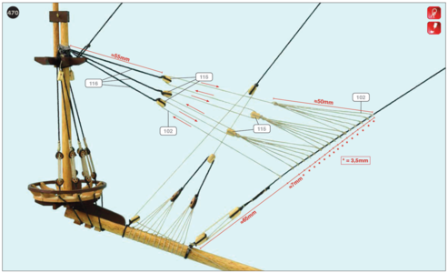

Instructions from 1:65 scale Wasa from Artesania Latina. Dimensions are provided.

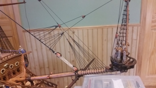

If this link doesn't work, see my build log post #2337 on page 117.

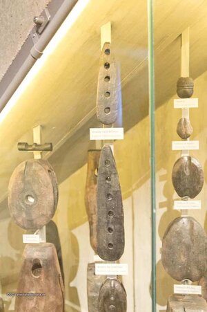

I think using euphroes are more historically accurate at the root of each of the crows feet than blocks which the Artesania Latina instructions indicate. Paul's model also uses euphroes.

You can make the euphroes out of a stick of walnut hardwood. Drill the holes arranged in a straight line FIRST do you don't risk splitting the wood, then cut the shape out, and file the edges with a shallow groove with the edge of a needle file to accept the pendant rope. Each one takes about 20 minutes. And they look sexy.
I agree--it also makes the job easier. Just be sure to put some tension on the stay so it doesn't get pulled out of line when you tighten the knots.
The euphroe blocks can be tricky at small scale. I found that when drilling 4-5 holes along the grain, when I rigged the lines, tension would split the block along the grain joining the holes.
So, I rotated my timber 90 degrees and drilled the holes so the line up of holes was ACROSS the grain. The tension on the lines never split the wood then.

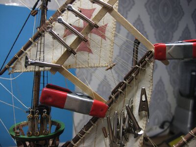

Maybe this picture will help you get the rigged lines in place when making these crowfeet. It is hard to hold everything in place when it is so small. but by making a construction to hold the euphroes in place it is easy to rig the feet of the crowfeet.
it was helping me and makes the job a little easier to do.
