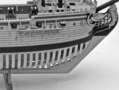

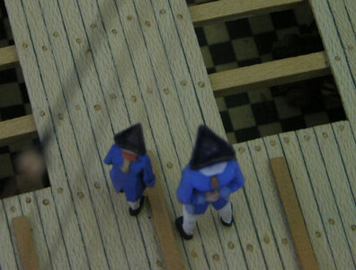

i started wooden ship model building back around 1965 i was building plastic kits since the mid 1950s. At the time the only kits available had solid carved hull there were no plank on frame or plank on bulkhead kits in the US at the time. so the idea of planking a hull was not heard of let along treenailing the planks. If memory serves me i believe it was Harold Hahn who introduced the first plank on frame models to the hobby through his articles in the Nautical Research Journal.

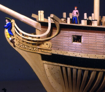

Hahn got the idea of using pegs from Robert Bruckshaw it was Bruckshaw that introduced Hahn to the "admiralty style" of model building. Looking at a Bruchshaw model you can clearly see the oversized use of treenails

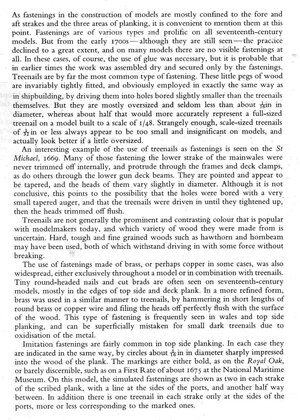

The question is where did Bruckshaw come up with the idea? From the Navy Board Ship Models from Franklin in his book tells us early models used wooden pegs, brass and copper nails.
Even though fastening did later fade away from the admiralty models it was Hahn who "stylized" the look in the hobby. You can see the oversized scale that was used by Hahn and his models look like he tossed a bag of poka dots at the model.
Both Harold Hahn and Robert Bruckshaw were the rock stars of the hobby and promoted by the Nautical Research Guild. Whatever they did was the gold standard of the time. What got them to stardom was the sheer quality of their work which by far overshadowed the use of stylized out of scale wooden pegs peppering their models.
Who knew?
at the time there was no logging on and googling searches of treenails or how wooden ship are built. The modeling community only source of information was a couple magazines and the NRG journal publishing articles by other model builders, there was a huge gap between the hobby and the academic circle of marine archaeology, so hobby builders took for granted if this is what the master builders are doing it must be correct.
Over time the used of out of scale wooden pegs became a model building style to show maybe the determination of a builder to show he spent the last 90 hours making little pegs just like the master builders did.
today with far more information we learned how it really was done with copper and iron bolts and spikes and not these wooden pegs. Is it time to break tradition and up grade?

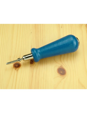

I perni finissimi Amati da 10 mm #4136/10 sono i migliori chiodi che ho usato poiché entrano anche nel legno duro senza spaccarlo e con il minimo attrito. Puoi spingerli dentro o picchiettarli con un martello. Altri spilli di Amato che non sono specificatamente etichettati come "finissimi" e sono troppo spessi. Cerca tutti i fornitori di modellini di navi online per il miglior prezzo. Ecco alcuni link:
Cornovaglia modellini di barche nel Regno Unito
Kit modello di nave in legno negli Stati Uniti
Avrai anche bisogno dello strumento di spinta del perno giusto. Quello a destra è per spilli fini con teste piccole ed è quello che vuoi. Quello a sinistra è per spilli con la testa più grossa e più grande. Ho due spingichiodi, ma non ricordo dove li ho comprati.
Questi chiodi li uso da circa 40 anni sono di ottone, li consiglio

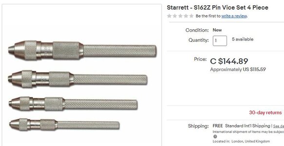

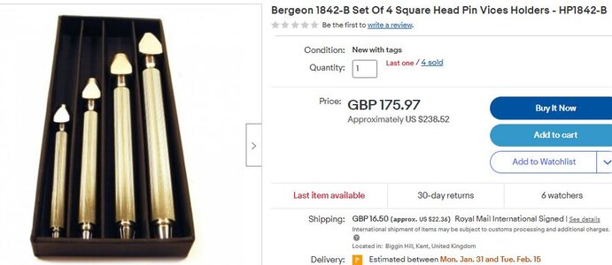

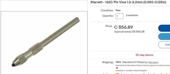

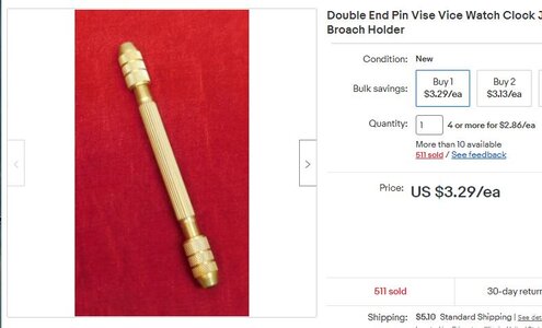

i started my investigation into pin vices thinking it is a simple tool
Really!
the price goes from $56.00 to $3.26 and there are so many kinds so why is there such a huge difference in price?
and a set of 3
or this set for a low low price of only $238.52

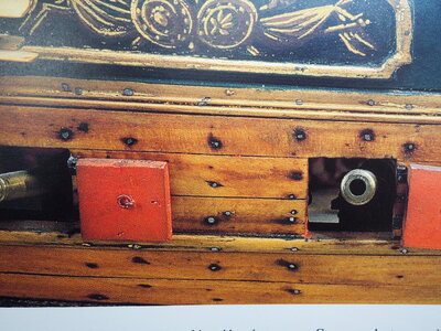

In museums you can see often nailed models. This is one of the reasons why many model builders want to do this. It is not necessary, because modern adhesives hold very well. In some places, nails (bolts) are quite useful to hold important components properly or even the smallest nails on rudder hinges. For most modelers, a model with the smallest nails or wooden plugs is also a "feast for the eyes".

Dave, as usual, often it's down to quality.....you get what you pay for.
However, over 20 years ago I bought a cheap set of 4 pin vice (around $5) which have done everything I asked of them.
That set, whatever its possible shortcomings, is a no brainer. I'd start there. Nothing to lose.
With all your experience I can't believe you got by without a pin vice until now.
I bought a little USB powered drill that came with 10 drill bits. It didn't work at all. Then I put one of my drill bits in it and it worked quite well. The bits in the set you are looking at may be just as bad(useless). $28 may be worth the gamble though.
i never used treenails on models so i really never had a reason to drill tiny holes.
i think i will try a under $10.00 pin vice and see how it works

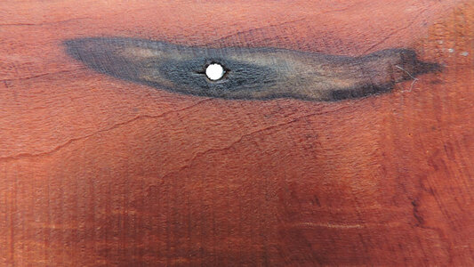

this is what happens when you use ferrous metal nails in some types of wood. I am not sure if brass plated nails will stop the reaction between ferrous metals and wood.
