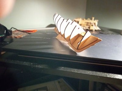

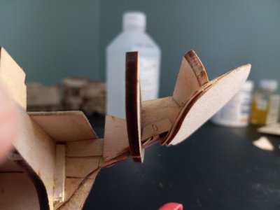

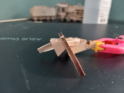

Is the gar plank glued into the rabbit or just set into it? CA good for this? if so, what thickness?

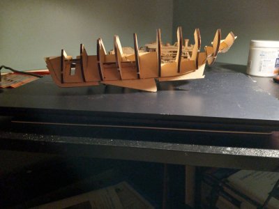

PVA will loosen when exposed to water or alcohol. Once you have the damp plank in the position you want, clamp it into place and let it dry before you glue it.I have the gar planks on, but snapped the next plank right at the bow. The PVA holds until I soak the plank. What would a good glue be for this repair.

After soaking the planks, if the part attaching to the frames is wiped dry, can they be glued immediately after with the PVA glue with clamps?Glue the gar plank into the rabbit. I like using PVA glue such as tight bond and clamping it into place. Don't forget to bevel one edge of the length of the planks so they fit together more closely. Also glue the plank edges to the next plank not just glue the planks onto the bulkheads.

I would perhaps use a hair dryer or heat gun to dry out the planks if you were in a hurry. I don't know if you drink the surface would do the trick.After soaking the planks, if the part attaching to the frames is wiped dry, can they be glued immediately after with the PVA glue with clamps?
I have been waiting overnight before adding thr next plans and was wondering if that would speed up the process.
