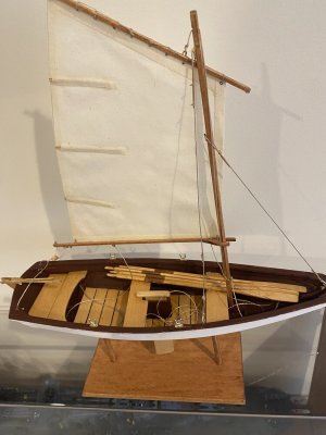

Ok, while waiting for my new kit to arrive I thought I would get the sails ready. I have seen some stain their sails with tea. That seems problematic to me as tea is acidic and I don't know how long before it would be, or even if it would be a problem.
What do you do to stain your sails or do you just leave them white, or whatever color your sail cloth happens to be?
I just left my Norwegian sailing pram the color it came in and I think it looks fine.
Rob
The model looks fantastic over all! What is the sail material? It looks so much better than the burlap like material found in many other kits.
