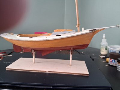

This is the Lobster Smack I have left after dropping one on the stairs, anf this is the Apprentice Kit I received. I will finish the Apprentice kit for my niece (for her mantle), then try to finish the paint job on this Smack.
The stem, which broke at the stern on both attempts, is much more robust on the Apprentice kit. I am using Evergreen PVA glue on this one and on any and all future models. Went down to Hobby Lobby for some artist's tubes of acrylic paint to see how they work on model ships.

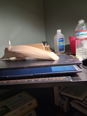

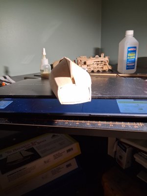

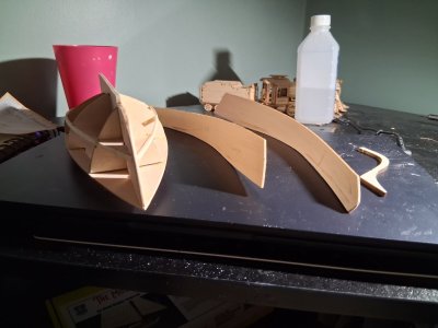

The stem on this one is much more substantial, but there is a top and bottom solid hull piece, no planking. The hull pieces are much heavier, so I soaked them in boiling water and got them to fit almost perfectly.
I watched Hill Billy Modeling, thanks for that tip.

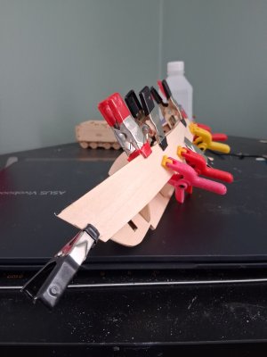

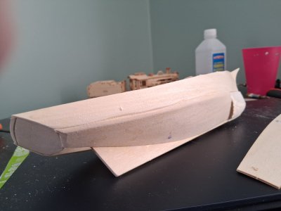

I soaked the upper siding in boiling water to soften the thicker "planking. It worked quite well. I also found out how painful boiling water can be on your hands.
First picture is planking adter boiling and bending, second ic upper planking glued to hull. Now to do the other side.
Probably a heretical approach, but how about ignoring the provided thick and hard material and skinning the sucker with 1/16 basswood instead? I ended up with two Sakonnet Daysailer kits somehow. The first I fought like a dog to use the thick stuff they provided for "planking" and it's OK but far from fun. Having a second kit on hand I tried using 1/16 basswood instead. Still needed a wee bit of water and some heat and gentle persuasion but the hull looks better, the job went quicker, and all seems perfectly fine. Just need to remember you don't have all that wood on the hard chine so care in refining the line with sandpaper is needed.
I haven't done the Lobster Smack yet, it's waiting in queue while I finish up a Mighty Mite tug and the two daysailers. Odds are I'll do a Dumas kit or two before I get back into the Midwest kit world. I sure do recognize that hard unyielding planking material you are fighting with through.
