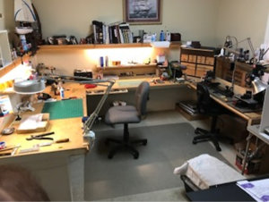

Mine is a countertop that was a take off from a lab remodel. Black lab grade plastic laminate. Set on two 2 drawer file cabinets and a couple end panels. I have a slab pf 1/4" glass on one spot. The glass is great when gluing or painting because anything stuck to it comes off with a single edge razor blade. (been there for 20 years with no breakage), a large cutting mat in another spot, A 1" X 12" X 36" slab of pinkish color marble from a reclaim store for $5.00 and a smaller 12" X 16" piece from a fireplace mantle for things I want perfectly flat. These I use also for tooling leatherwork.
Donnie

WOW - what a nice bench - Now, I have to go take a pic on mine LOL;)
usually the height is 29 inches or 730 mm
