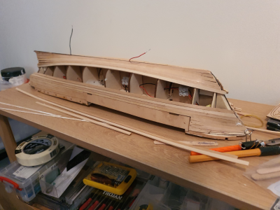

Wiring, installing & testing the internal lighting. A bit more fiddly than I expected, but so far so good, you might note I have left a wiring attachment to wire in running lights on the masts
Progress is slow but is getting there. wiring within the hull complete and building the hull. planking to start and then there will be no access to hull interior

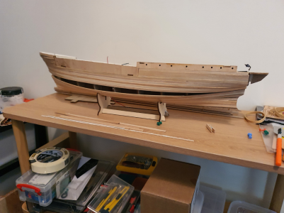

Commenced first Planking. you will note I am clamping & glueing and trying not to use nails. See how we go
