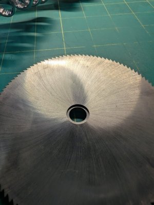

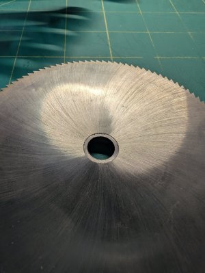

Reviving this old thread to post a minor warning when changing your saw blade. Ever since I got the machine I've not been having a ton of luck with it and so I put off checking out until I need it again and then get terrible results and put it away again. I got it out again today to repeat the cycle when I noticed that my blade was actually wobbling. Not side to side, but up and down (or back to front). In technical terms it was wobbling perpendicular to the rotary center line of the arbor shaft.

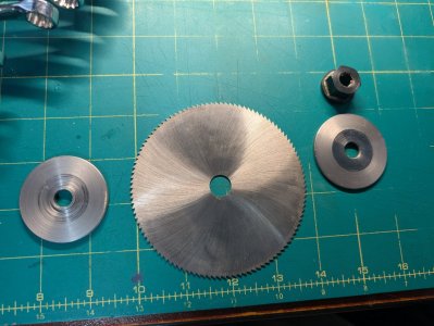

This is because there is a small lip on the inner arbor washer that is supposed to be inside the hole of saw blade. Mine, for whatever reason, was not fully seated onto this lip.
It is a very tight fit, almost verging on a press fit. I really had to work it down to get it seated.

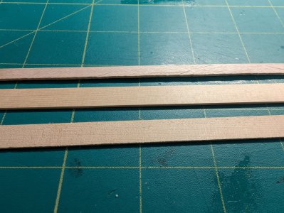

Once I got it reinstalled and tested it again, the results were far better than anything I had previously done. Top one was done a few months ago, bottom two I just did now.
So, just something to keep an eye out for. It's very easy to not get this seated correctly.
