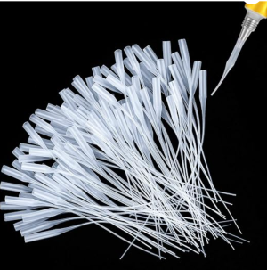

Try using the extended tips available on ebay etc very cheap in larger packs rather than 5 or 10-packs offered by hobby shops. The glue will dry in the tip sealing the bottle, then when you next use it, just snip the end off. I use BSI odourless.
As was noted above, get extended, fine point tips. I got these from Amazon:
