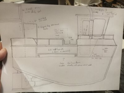

I made a quick 'n dirty sketch of what this thing might look like when done. it is gonna require quite a lot of modifications and hack & slash on the hull. probably the nose needs to go a slight bit more forwards to have enough room for battery etc. inside.

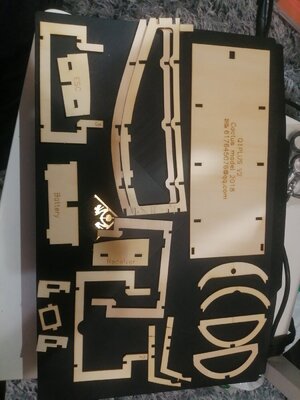

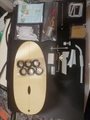

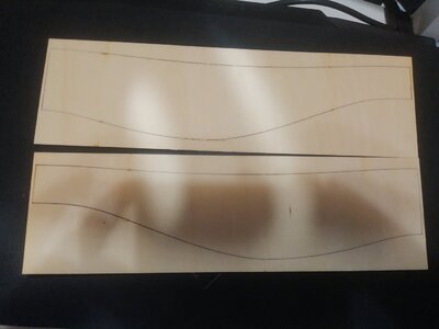

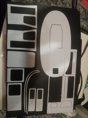

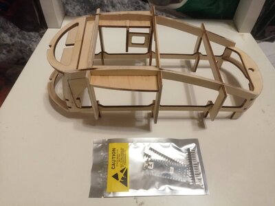

Here are images of the kit parts. hull is mainly wood, while the steering hut and gunwales are plastic, as well as axle housing and rudder. i will use only the plastic cabin and the small gittings on cabin roof, i will make a new deck from probably plywood, and new gunwales, but i'm not yet sure if they will be wood or plastic yet.

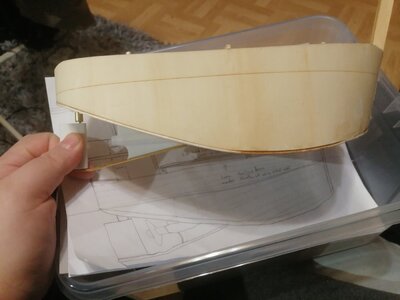

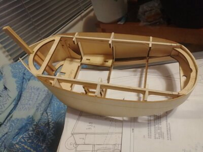

Got some more bodywork done, and glued on the bow. it's overly long, i'll cut it to size when i get the bottom of the hull, main deck and the front former and deck glued in. i also glued two support beams next to the bow for the front hull sides to attach to, they will be glued in tomorrow.i don't mind too much about the look of the fuselage's outer sides, as they will be covered with planking later on.

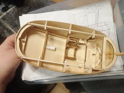

Bottom plate, bow panels & Propeller shaft tunnel/keel and rudder glued in, next to make theglue seams watertight with epoxy. then i can make the two nose formers for front deck, but can't glue them in yet. then i have to wait until i get back to my home in Oulu to be able to glue the deck on as i have to install the servo and motor beforehand.
