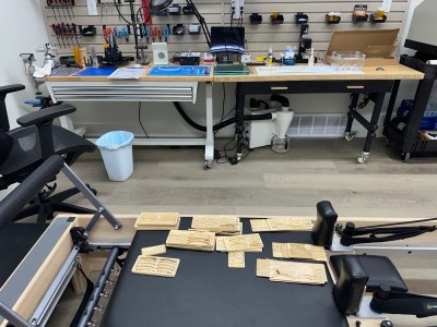

The kit's wood is excellent, close-grained, sands easily. Frame futtocks are CNC, the spacers are either thin wood or 3-d printed plastic. Instructions are clear, with a couple of labeling mistakes that are easily identified. So far, the kit is a lot of fun, and superb. I picked it because it is not a huge project (could be done in the afternoons after a ski day) , and the construction of its intricate and complex frames will be a good training for the biggie 1:48 Dockyards' Enterprize to be built in Houston.

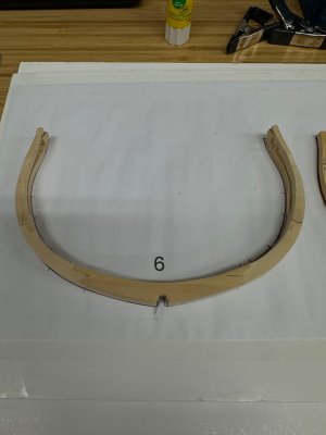

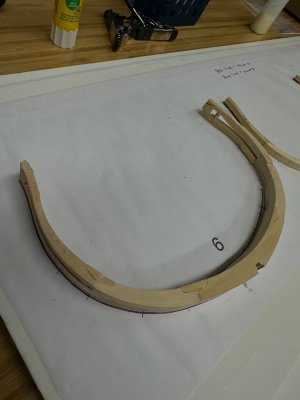

The cross section is made up of 9 frames (From frame # 6 to frame #14 of the full framed ship); each frame made up of two half-frames (actually futtocks and floor timbers) - for simplicity, I am calling them half frames, "A" and "B". The frames are complex.

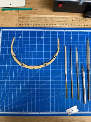

The picture above is half-frame "A" of # 6 frame Shows the CNC-cut floor timbers, chocks and futtocks.

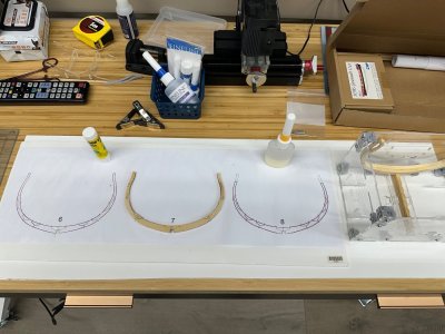

This is completed frame # 6, not sanded. To build each frame, I glued the trimmed and sanded futtocks of half-frame "B" to the frame plan on a poster board with tacky glue, then glued the futtocks to each other with wood glue; then glued half-frame "A" on top of "B" with wood glue. Plastic spacers (3-D printed plastic) are inserted between the half frames to space the top timbers and futtocks 3 and 4. Did I say the frames are complex !

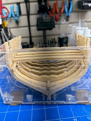

The building jig is a real pleasure., It is made of engraved, high quality clear acrylic panels and was easy to build.

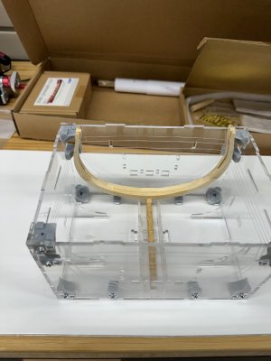

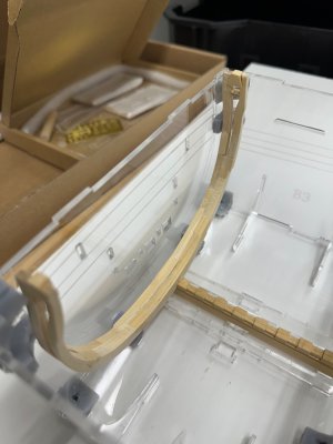

Picture above shows frame # 6 dry-fitted on top of the keel. Notice the spacing between the top timbers.
Later I plan to insert metal (.6mm wire) and wood treenails.
Another picture of frame # 6 dry-fitted on the keel, inside the building jig.

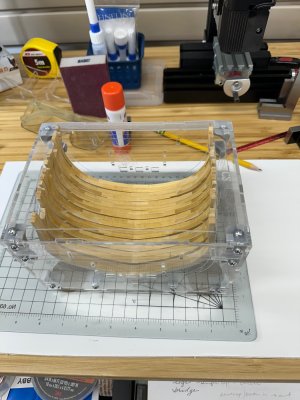

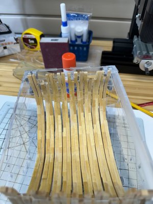

Over the last couple of weeks frames #6 to # 14 were assembled, and glued onto the keel. They fit tightly into all the slots of the build jig.
Next phase (to be started in early June) will be to finish the upper bulwarks details, treenail the frames' futtocks and finish sanding. A lot of fun so far.

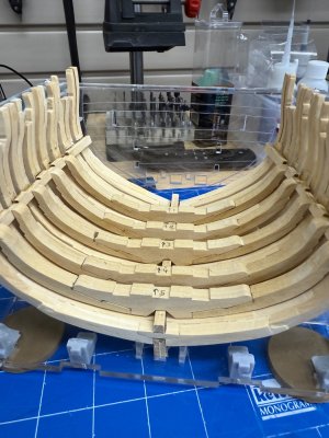

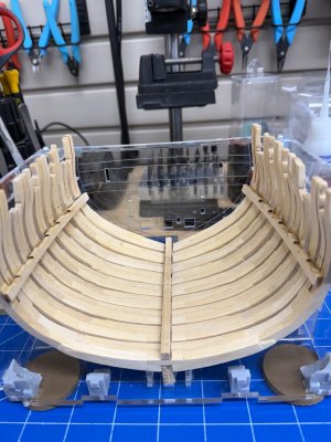

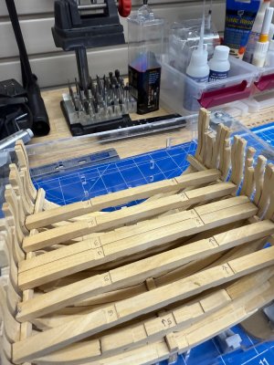

Progress on CAF's 1:48 c ross section:

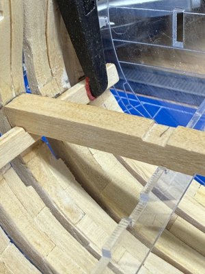

First pic shows the assembled frames with keelson and the all-important deck clamps. It took some ingenuity to get them positioned perfectly, but it is the most important step in this model. Screw the position and symmetry of the deck clamps and everything else will be ruined!
Second pic shows the inner planking with thick stuff.
The third pic shows the futtock riders placed over the frames, before the inner planking.
The fifth and sixth pictures show the riders and the beams placed in their positions-unglued of course.

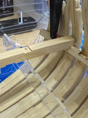

Seventh pic shows a beam dry fit on the clamp.
Next: finish sand the inner planking and then sand bevels and slots for the thick stuff on each of the five futtock riders. It will take a while. The starboard side is left mostly unplanked, the port side is fully planked.

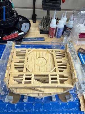

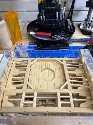

Progress on CAF's 1:48 HMS Granado cross section.
The acrylic build jig has worked very well. The lower decks, shell room and structure is essentially finished. Half of the ship will be planked, the other half left un -planked to show the structural timbers.
Next, build the mortar box and plank the upper deck and bulwarks. After that, the cross section will be removed from the jig to sand and then plank the ouitside.

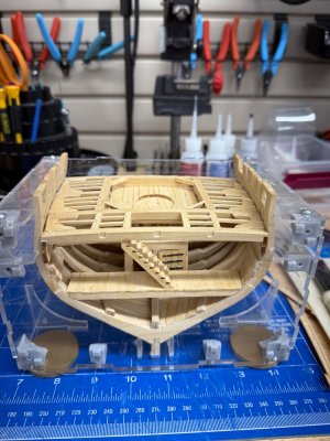

Progress on HMS Granada cross Section 1:48.

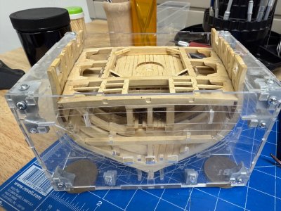

Still work left to be done, but nothing structural. The acrylic build jig-box was excellent, everything was straight and aligned after removal from the jig. Still to be built are gun carriages and sliding mortar cover. I need to blacken the guns, mortar and hardware and plank the outboard port side. After that, detail filling and sanding, oil stain/ varnish and paint.
Any suggestions on what to use for oil/varnish ? This pearwood's grain is so close, I want to make sure I use the correct product.
I am going to paint a few parts (wales, bulwarks cap rail ) black mortar enclosure bulwarks, gun carriages, etc. bulwarks red.
Suggestions on paint brand, colors ?
Early on, I decided not to tree-nail the model.
Should I leave it like that, or tree nail the deck, or even the exposed carlings and lodging knees ? ?

Only my opinions....
I believe pearwood presents beautifully under boiled (polymerized) linseed oil. Tung oil gives a similar finish but takes much longer to set up.
For the red I read somewhere that vermillion is a nice match for period red. Vallejo is a quality brand.
I would think it would be difficult to add treenails at this point. I would stick with your original plan.
Of course it goes without saying that you should test any finishes/paints before applying them to your beautiful section model.
