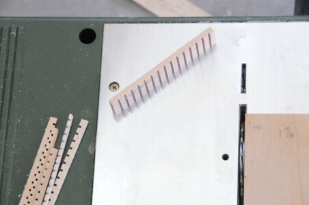

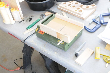

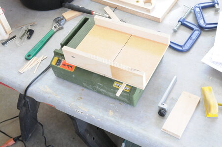

do you want to create strips for planking? veneer for final planking? grating? small parts to use in ship building? I would first use the tools with scrap to create truly square, dimensioned lumber. You have a diverse set of tooling and you should practice. Start by creating an accurate drawing or plan and then make the parts to fit the drawing. I have the Proxxon mini tablesaw and use it to make my own grates. put them through their paces and see what you can do for accuracy. I personally would start with basswood. See what you think. Also, consider making jigs such as a cutoff sled, featherboards and a taper jig....

The grating picture I get...
What am I looking at that is sitting on your table saw?

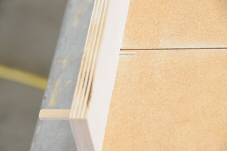

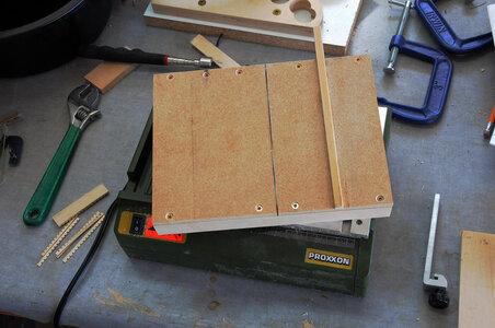

The thing sitting on the saw is a crosscut sled. It makes cutting square crosscuts easier. And this one has a key that makes cutting notches for grating pieces repeatable. A lot like machining finger joints. I retired from engineering in 2012.....

Got it. How is it attached to the table?
I assume it slides across the table as you make cuts?
