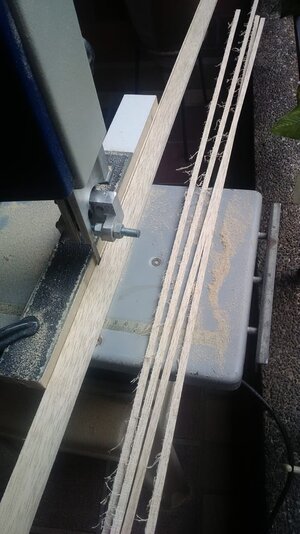

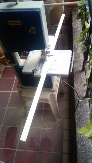

Utilizo el mío con mucho éxito. las tablas que necesitaba conseguir eran de 1,5 mm. Luego los pulí con papel de lija y quedaron muy bien.

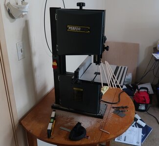

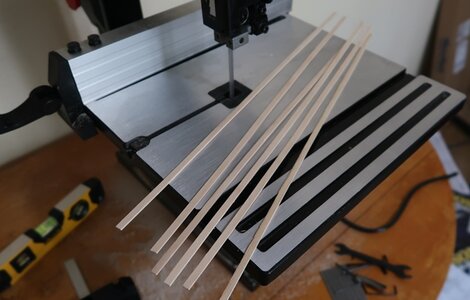

Just got this the other day, shout out to Don Farr for recommending this saw, set up was a bit tricky, but nothing major. Just a few test cuts for now, had to order some fittings to connect the dust hose to my shop vac, but overall, pretty nice saw.
