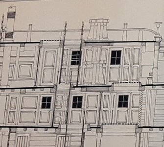

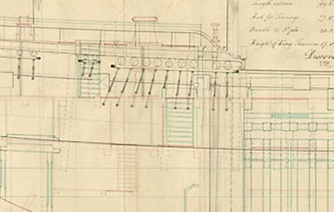

This is a portion of John McKay's drawing of the Discovery1789. If you look on the QD you can see that the bars would clear the stairwell rails but down on the main deck you would have to pull the bars on every revolution to clear the stairs. Is it possible that they used the lower portion for the messenger and only used the bars up on the QD?
Hi Don. Is that drawing distorted. The capstan shaft is not square with the deck. The QD hatch is double. Swap the grating and the ladder around and it will work. I think that's an error.
Thanks for the answer. Yes it's distorted. It's phone picture. I wondered about swapping them around. It would make the bars about 3' long. That's not much leverage.
G'day Don, maybe the stairs were made to be removed when using the capstan, i know that on the HMS Victory on the lower deck that they had support pillars around the capstan that they removed when using the capstan, just a thought,
best regards john,

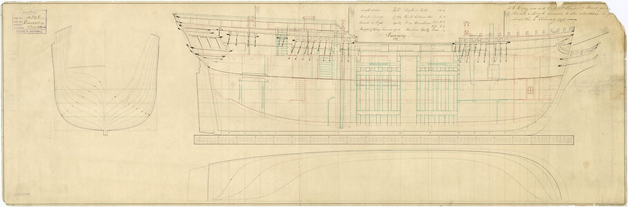

Yes that's when they were converting her to a bomb. The green is proposed, red is existing(if I got that right). This is J022 which I think is a proposal drawing. There are two sets of deck drawings that kinda go along with that, J2024 which is the proposed and J023 which is the "as fitted". You can see on them that they decided not to move the lower deck/upper deck stair to the aft hatch. They left them where they were but it also looks like the QD to upper deck is right up against the capstan.

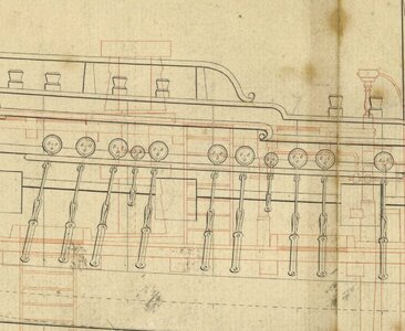

Some days ago we had a short talk about a similar problem with the Le Fleuron and the length of the bars
I guess it is also interesting for you
