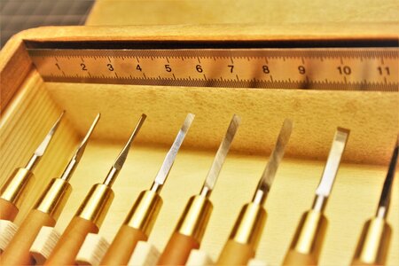

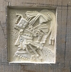

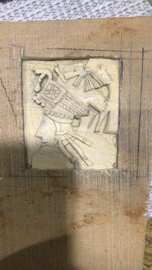

I have started to work in some decorations. But it is quite frustrating . They are smaller and the technic is completely different.

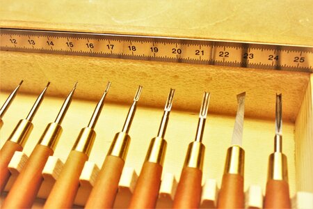

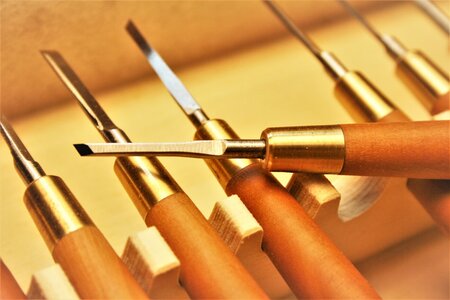

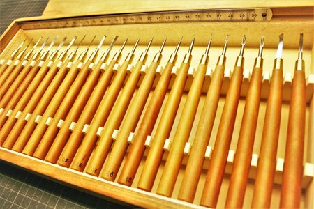

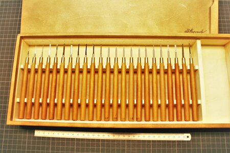

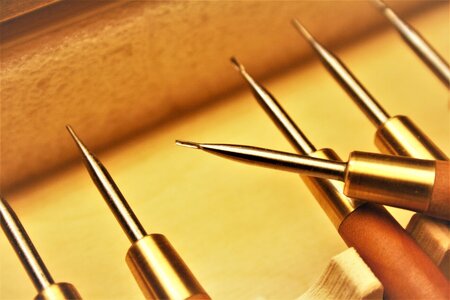

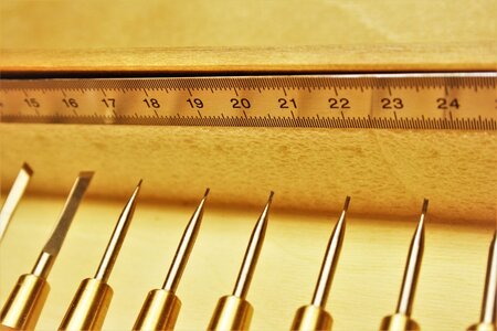

I saw you bought some rusian micro tools. How big are they?
I have my set already some years, the smallest are 0,5mm
IMG_37761.jpgIMG_37771.jpgIMG_37781.jpgIMG_37791.jpgIMG_37801.jpgIMG_37811.jpgIMG_37821.jpg
These are very good small chisels.
Other carvers, which are masters like @Ivan Trtanj are using only high speed electric drills from dentists etc. - As I know Ivan is not using chisels since years
