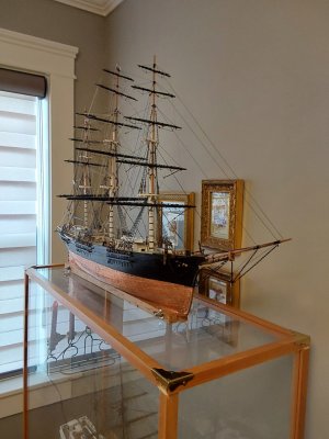

Forgot to mention , I built cases for all my models and also
all rigging was beeswaxed ,,no rigging sagging to this date on
all models.
My models are all bear pole ,no sails,thus in time sails tend
to fade and rot, then try to find a model maker willing to
repair them.
All my models were scratch built except the Flying Fish which
should have been as the Kit was terrible.
Winova
