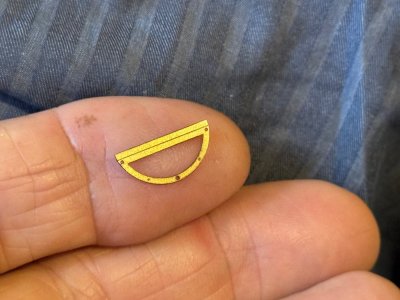

Another approach is to use a CNC fiber laser. This is a top for HMCSS Victoria which is being made for a friend. It is 0.25mm thick, 16mm long, and the 0.5mm holes are centered in the semi round which is 1mm wide. The 30w laser took 90 seconds to make 4 of these. (and no smoke!) The fold line and 2 of the holes were cut at half power. Previous attempts using CNC milling and chemical etching were unsuccessful due to the holes breaching the edge of the round section.

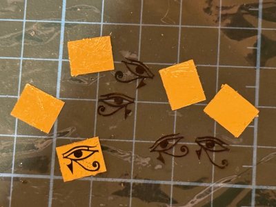

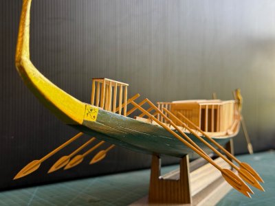

25 Dec 2025. And if I may bang my CNC laser drum again, some parts made on the 30w fibre laser for the Khufu pyramid "solar" ship.
These are brass cutouts for the sides of the hull near the prow. They are 11mmx9mm x 0.1mm thick. The eye is painted with black acrylic ready to attach to gold foil covered brass backplates.IMG_6756.jpegIMG_6760.jpeg
