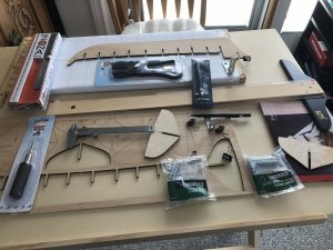

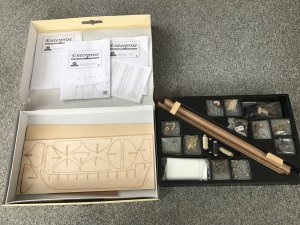

“ OK” How do I do this Log.
It starts with the arrival of a birthday present.

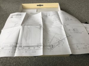

Opening the FEDEX package I find this.
Opening the box, it’s WOW, OMG, HMM.
Some time is spent looking at the contents.
Time to do some research.
What do I need for tools, what books for research and where is there a out of the way spot to store and build this.5B15A55E-F686-40FD-BD2B-3DFD2F3DEC72.jpeg697F97DD-9CDC-4371-9DC4-530FC6F32521.jpeg

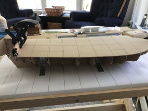

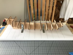

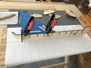

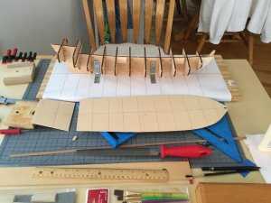

Squaring and gluing the frames.
I used small angle brackets fastened to a 3/4 in piece of plywood to hold the false keel while gluing the frames. Clamps and a 45/90/45 triangle were used to square the frames.

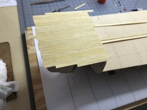

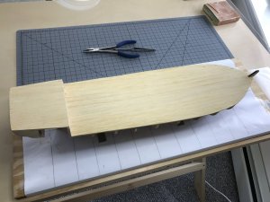

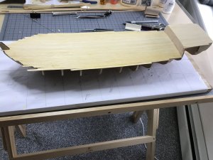

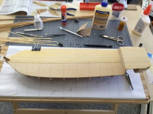

Deck planking.
The first deck planks were glued using the centerline mark as a guide. I used “Titebond II” wood glue. I lightly brushed the plank and the deck with a small amount of the glue, placed the plank and wiped off any excess glue with a damp cloth. I glued four planks, waited a day for the glue to dry and set and then repeated the process.
70670572-F7B4-4D63-9778-47E5A1942270.jpeg03FC76D6-55D7-4A40-83F5-44ABF1C7E3D5.jpegEA9E3447-8FD3-49DA-9479-E79C22E4EBAF.jpeg8435FA4D-50C7-49D0-A769-8E6E2E48F4C5.jpegA7A16208-D8C1-4BAF-9EE4-CE6F00C89EC9.jpeg
Excess planking was cut off and the edges filed and sanded even with the edge of the decks.

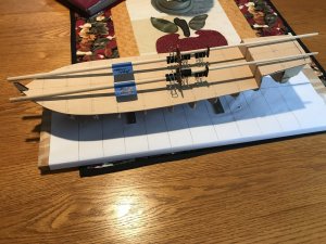

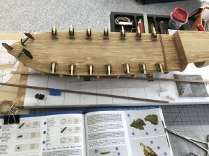

Another head scratcher.
I set the hull to the side after the deck planking and thought I would start working on some of the other steps of construction.
The masts and bowsprit looked like a good place to start.

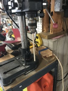

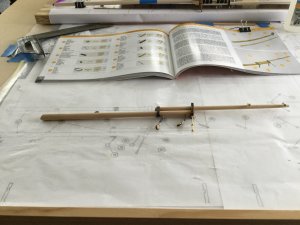

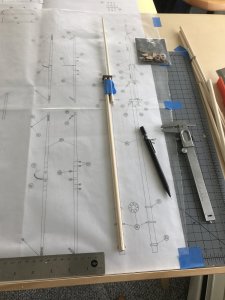

“Cut and taper the bowsprit and jib boom according to the measurements of the drawing” is what the instructions indicated. Look in the “how to books”, look at “You Tube”?
Decided that I could do a good job with this setup and different grit sandpaper.
I added an extra 3/4 of an inch added to the dowel length to allow clamping the dowel in the drill chuck. Using a set of heavy duty work gloves and sandpaper I was able taper the dowels in a few minutes. Once the dowel dimension fit the plan I cut of the extra bit of dowel damaged by the drill chuck.
