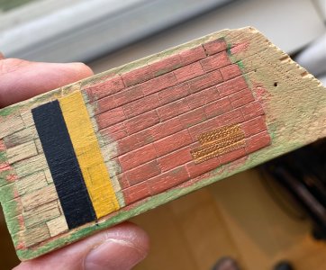

This is how it will look like. Painted over green painted wood strips and slightly sanded. It is acceptable but not comparable with tea copper.

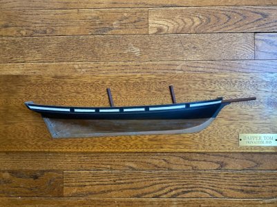

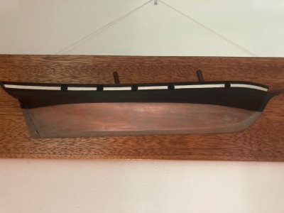

Corsair's comment regarding the importance of scale is on target. Once again, we are addressing matters of accuracy, appearance, and the physics of scale. The process of attaching individual copper bits to a model may be "accurate" as it roughly represents the process of attaching copper to a vessel. However, is the thickness of the copper to scale (probably not, since copper sheathing was pretty thin)? Does the completed sheathing look like what one would see on an actual vessel? The first picture below is of the Cutty Sark on display in Greenwich. You can discern a pattern of plates on Cutty Sark's shiny new copper, but they are not nearly as pronounced as those shown in post #3.
Second and third pictures are of a simple half-hull model of the Dapper Tom in 5/32" scale. The rough-carved, solid hull was rescued from the reject box at the old Model Shipways shop in Bogota NJ. I painted her below the waterline with copper paint with some green worked in to represent verdigris. If memory serves, I used Testors enamels in the little square jars. I think this is fine for such a small, simple model.
So, each modeler gets to make their own choice. Fair winds!

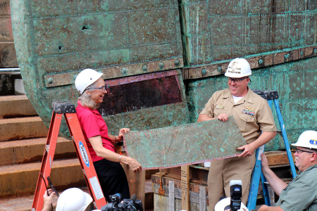

Real copper sheathing is applied using a special hammer with a large, round convex-shaped head. This hammer face produces a dimple in which the tack head lies and yields a relatively smooth hull surface which enhances the vessel's performance. Models which have wildly out of scale "rivets" or "pimples" all over their "real copper plates" (as some kit manufacturers tout,) don't create a compelling impression of reality. To my eye, and I readily admit this is a matter of taste, a shiny coppered bottom on a model is distracting and draws the eye to a detail that is of little interest or value, compared to the rich detail to be found on deck and aloft. Your mileage may vary, of course. ;)

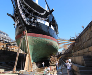

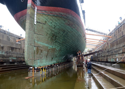

USS Constitution's bottom from perhaps 25 feet away after being scrubbed and exposed to the air for a while during haul out for restoration:

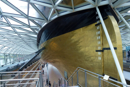

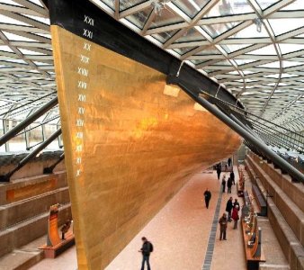

Cutty Sark's Muntz metal bottom properly fastened from 35 or 40+ feet away:

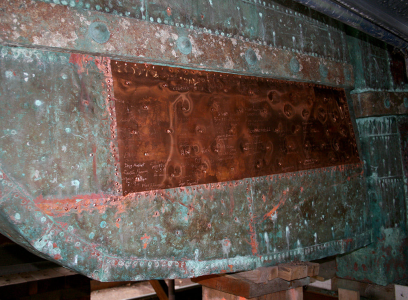

USS Constitution's bottom from about ten feet away:
USS Constitution's from about 100 feet away:
USS Constitution from about 50+ feet at the rudder to midships:

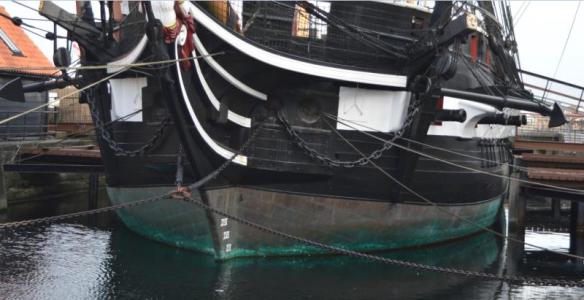

HMS Trincomalee showing naturally weathered copper sheathing above the waterline with verdigris patina at the waterline from about 50+ feet:

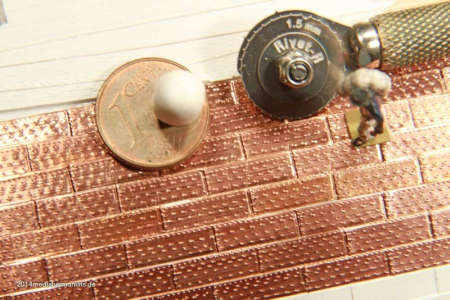

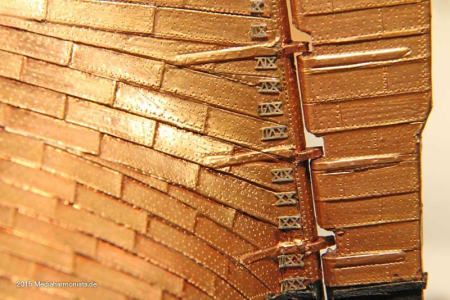

Model, scale unknown, with interesting nailing detail, but out of scale plate thickness:

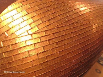

Out of scale "pimples" and "brick and mortar" looking plates on a model hull:
