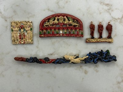

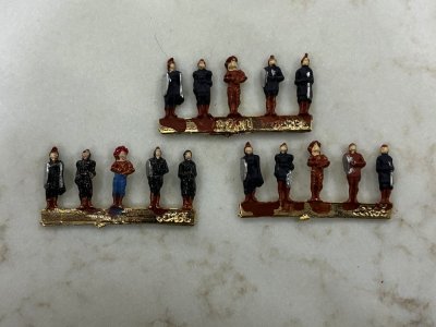

I am using the build guides for the De Agostini version of the VASA. Granted, these are speculative but they do add some color to the ship. I have read that its estimated that the actual ship had over 700 such decorations. Cornwall boats sells complete sets of figures but don't think I'll zealous. I haven't counted how many came with the kit. I might look into get one set but, as I suppose those of you who have build this ship, you, too,
have found the painting these figures is fun but it is very time consuming. (The brownish-red ones are primed and ready for painting.)

The build guides for the De Agostini (Model Space) are downloadable from its web site. These guides have pretty extensive painting instructions (photos, color pigments, etc.) and I have been using them for my painting efforts. When it comes time to paint the hull, I'll be using Vallejo's "Vermillion." For the figures, I have been using Testor's and Ammo paints. Ammo has lots of colors for military figures, some of which are good matches for the MS-indicated tints.
