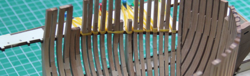

Since none of my frames are glued onto the keel yet, I took out all the frames and then the keel so I could better see things and checked the fit of each frame individually onto the keel itself. Now that that is done. I have put the keel back in the construction jig and made sure that the slots on the keel match up with the slots in the construction jig so it will result in attaching the frames at 90 degrees. I will start gluing them in place soon and I still need to sand the bevel onto the edges of frames 30 through 37. :)
A very decent model and kit in general, especially in 1/48 scale. If I were choosing the next project, this kit would be at the top of my choice. But I have 3 unfinished hulls there, that's enough for me for now :cool: ROTF
