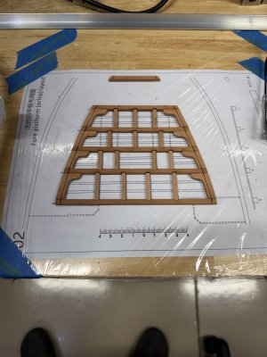

In my construction of the first deck section, I'm combining steps 45 and 46.
However, I did notice that in step 46, they list the part numbers backwards.
The E2-13 knee should be closest to the bow and the E2-16 knee should be on the end away from the bow. :)
I'm sure most people would figure it out since they are not the same sizes and would not fit over the plans properly of not installed in the correct place. :)
I guess a little of my OCD is being exposed. LOL
Thanks for checking in on me. :) I hurt my right shoulder (of course I'm right handed) a little while back and it has hindered my ability/desire to work on the ship for a bit, but I am back at it. I've got the steps, crutches and breast hook installed and starting to work on some of the lower deck framing now.
View attachment 620412View attachment 620413
