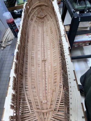

I'm still here. :) Ok, I finished the inner planking (except pieces I need to add after I install the final transom pieces)
I have a few crutches, the breast hook and 2 of the three mast steps. Then I start on some deck framing. :)
Ooh! A picture that shows a beautiful build! Way to go, Jeff!

A very nice outcome of the inner planking, Jeff.
For sure when she is finish she can sail over ‘The Endless River’ to the see.
Very beautiful and very neat! It can be seen that careful thought was put into the production process Thumbsup Thumbsup Thumbsup
Thank you my friend. With the quality of your work I keep seeing, you words mean more to me that you can ever know. :)
