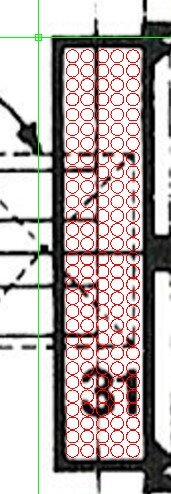

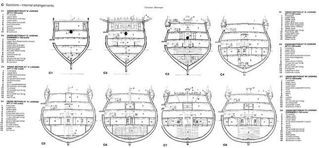

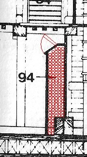

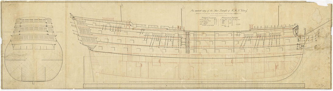

As an engineer I like to draw these things out, so have scanned in the book, set it to scale and thus am able to draw the cannonballs at scale over these plans and sections.
From this (and not even allowing for shelving thickness) the maximum no of shot in the locker would be around 3400 (so in reality likely 3000 per locker).
Based on that estimate you would need 3 of these shot lockers and yes contemporary plans may simplify it to a single locker I can't see where else the remaining one could be located (obviously the second of the 3 is located on the foreward side of the main mast enclosure as per more historical plans).
My suggestion on the cannon ball's being 'loose' in the hold - I envisaged them being located in an area of their own (not surrounded by barrels (as you state difficult to get to) and yes they would have to move them round to trim the ship but no more work than moving the barrels, but if they were in plank cradles of 3 cannons each (with divets for them to sit in and rope lifts each end) they could be stacked more securely and be easier to move around, including winching them upwards.
As I said, my main issue with these shot lockers is how they get the cannon balls in and out (especially in the heat of a battle) given the restricted access (as you can see on the section I've shown in red the maximum open position of the hatches before they foul on the beams above - how would someone (even for the young 'powder monkeys') be able to get in, lift out a cannon ball and then be able to fold up the shelf to access the cannon balls below. The only alternative would be to have doors at the fronts but that would have reduced storage area to keep access clear, hence why I suspect this arrangement may not be correct for cannon-balls

First what was the diameter of your avarage shot in there? Then by your drawing I already count about 3700 with plenty of air in between. In reality the balls would be stacked in triangular pattern both horizontal and vertical. So I believe one would come close to the needed 5000 per locker (plus the ones in the shot garlands). Almost the factor 10 of your first estimate in #4 on dgws :)
Also do not take the measures of McKay. Use the ones Uwe gave for a 100 gun ship in #4. then pack the balls triangular and hopefully the missing 1300 balls will possibly appear :)
Also there is mentioned a middle partition, thus providing the separation between different diameter of shots. So you can include the different diameters of shot in your calculation.

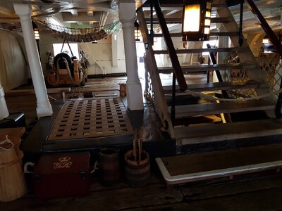

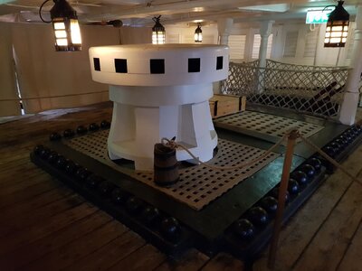

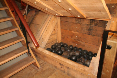

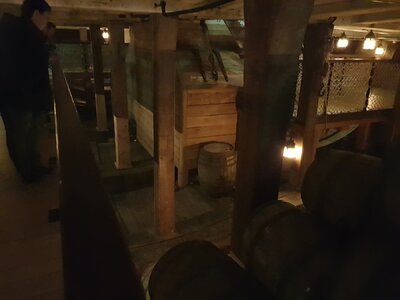

Also the flap at the top is not as tight as you think. Here a picture I took severalyears ago. One has to climb down and get the balls up. Forget the stairs in front of it, that is for the tourists only, but can serve as scale.

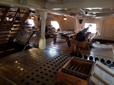

Also we are not in fregate war when surprises happened, in the fleet actions there was usually enough time to prepare. Getting the bulkheads and other stuff down - or overboard - and the shot up, the shot still had to be derusted if nescessairy and was then stored lying on deck nearby the guns with netting or in racks. Several of these were found in the wrecks of St. George and Defense of 1811 in Thorsminde. Also one sees that the shot sits in quite deep, so little danger of falling out in waves but much more the difficulty how to grab it ...
After all was prepared for Trafalgar they had some hours still to wait for action while slowly approaching the ennemy fleet.

Thanks - make more sense - I redid the sketch using just the 100mm dia (so smaller 12 pounder 4.4" should have been 112mm) sizes and that comes to nearer 4300, but given the main armament was the 32 pounder they're 155mm (6.1") or the orginal 48 pounders then quantity would have been reduced somewhat.
Would there have been an access platform in front of the shot locker though given this would have further interfered with the opening above - the locker itself prevents the larger barrels fitting through the remaining gap as it is.
No plateform but plenty of barrels bedded in shingle that could serve as one :)
And the grating on top of the shot locker was not intended for barrels ?!?
