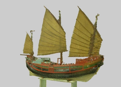

Seriously :rolleyes:, no one knows what the real 'Santa Maria' was like, but we can quite safely assume that she didn't look anything like this:
That saying, good old Christopher might have dreamed about making his retour jouney with one of those. :D
