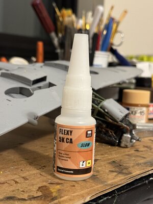

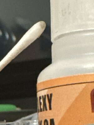

I’ve been using VMS’s Flexy 5K CA. It’s made in Poland and can be ordered directly from them or it can be bought in hobby stores in the USA. So far it’s worked pretty well, a little goes a long way. I’ve been applying it with mini cotton buds that come to a point so it’s pretty easy to get the CA into tight places. I was using the glue loops but they seemed to be more trouble than they’re worth. Those buds are a great way to apply paint also. I would bet that most artisans here have probably already discovered both. I’ve used it for photo etched brass together with styrene and plastic to plastic. It’s a pretty good bond.
