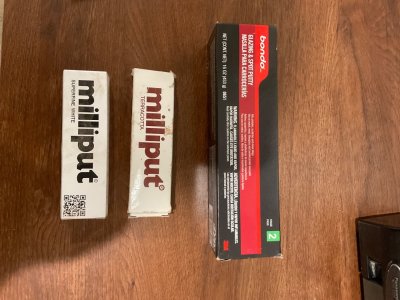

My current favorites are Milliput and Bondo Glazing & Spot Putty. Milliput is sandable and solid and the ability to shape it with a damp knife is really useful. It takes a long time to dry but has a fine finish and is paintable. I use it as both a filler and, as it is shapeable, to fabricate small pieces.
To get a really fine finish, for instance on a solid wood hull prior to painting, I use the glazing putty. It dries quickly, sands easily, and accepts paint well. You can’t use it for anything that is “structural.”
I usually by my fillers from Amazon, but here is a photo for those that still browse aisles!
