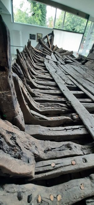

Actually the point you try to make is even incorrect, there are plenty of examples where ligger and oplang do not reach each other to form one ridged contruction.
As example I show you for instance Scheurrak T24. You see ligger and oplang not touching each other and they have used a small filler piece to fit the ceiling planks. You see the use of small filler pieces often, E81 is also an example where you see this in many of the frame members.
Drawing a frame contruction is a Dutch ship is a tough job anyway as every frame position is differenly build up depending on the available wood.
See below as example anpother Dutch wreck from the 17th century laying in Husum.
Looking forward to your shipmodel building blog or your upcoming book on Dutch 17th centrury ships.
