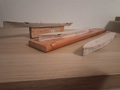

As in my previous builds, first thing was to find same good deckplans, which I managed for DEUTSCHLAND and VICTORIA LUISE, but not for HANSA. I first sawed the lower decks from 10 mm plywood. When I built my WILLEM RUYS (see https://shipsofscale.com/sosforums/threads/willem-ruys-1-500-waterline-model-from-scratch.14555/) I tried to recreate the sheer by wetting and drying her decks, which did not turn out as I had hoped. Therefore, this time I´d try something else: attaching various layers of thin wood to the "base", and finishing off with an end-to-end deck.
I applied B-deck to what I had so far, thereby finalizing the hull. This is the first step in which the three models differ: While originally the welldeck (I hope that´s the right term) was open, it was closed when Deutschland was transformed to Victoria Luise. You can spot that difference in the pic below.

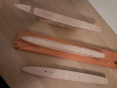

After that, the next step is to carve the hull and turn the layers of plywood into something like a ship. To do that I first made some frames/stencils:
Based on these, I carved the hull. Unfortunately, the wood I used for the "base" of the ships turns out to be quite soft and almost impossible to carve. Next time I´ll go for proper wood, as a forum member already suggested in my Willem Ruys thread. I guess sometimes you have to learn it the hard way ;)
Also, I´ll have to buy some proper filler, the one I have is quite crumbly. Anyway, this is where I stand with the first of the three:

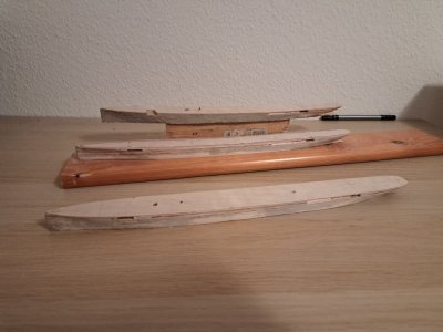

I could not spend much time on my models in the last days, but here is an update finally. I am almost done preparing the first of the three hulls for the next steps.
Finally, I could spend a bit of time on my models again. As you see, I am still in the process of carving the hulls. The one in the middle is ready for the next step. The one to the front is almost there, and the one in the back I just started.
I was surprised how challenging it is to shape the stern with its concave and convex lines. It is what makes the liners from the Victorian (or, in this case, Wilhelmian) era so unique, so I do my best to get them right.
