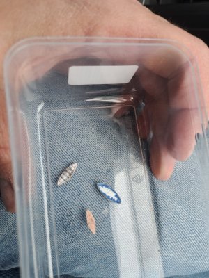

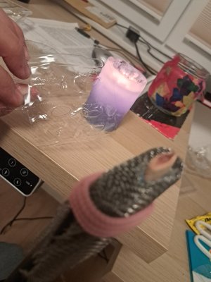

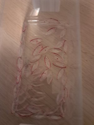

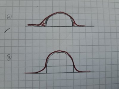

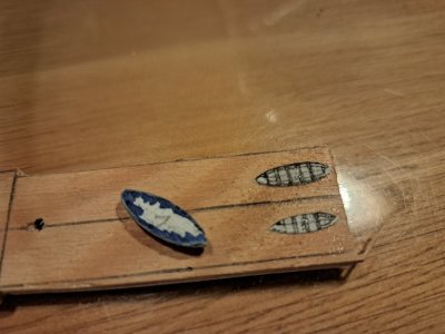

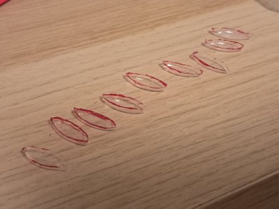

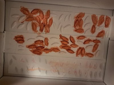

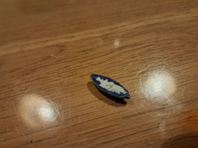

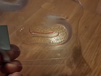

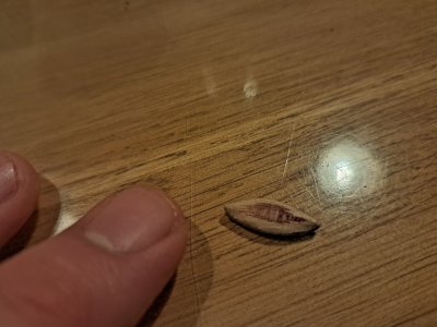

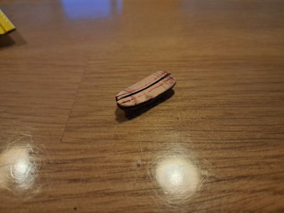

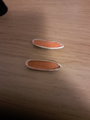

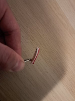

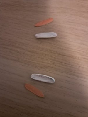

Yes, I guess vacuum forming is the english term I was lacking. I'll definitely check your post, Roger. Thanks for the hint!Now that you have a mold, by making the boats from “heated plastic sheets” do you mean vacuum forming? It’s easy to do with a household tank type vacuum cleaner or better yet a shop vacuum. If you use the search function you should find a post from me showing my setup.
Roger

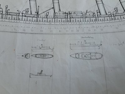

Thank you so much for your reply, Roger, I really appreciate it. I followed your advice and increased the temperature. In combination with my adjusted (thicker) mold, it now works a lot better. Still takes more time than I had expected, but getting there.I would form them in halves split longitudinally. If done properly you will end up with a flange on the bottom that serves two purposes; it is a surface to glue the halves together and it form’s the boat’s keel.
Off hand from your sketch I would suggest one of two problems insufficient heat or vacuum. When you heat the plastic it will sag. If you continue to heat it it should tighten up again. That’s when it’s hot enough to form.
Roger
