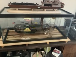

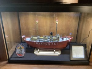

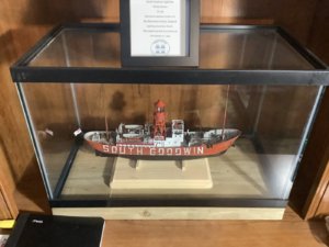

AFTER MANY YEARS OF SEARCHING for display cases that i can afford, a member on SOS had a post do not remember who it was but THANK YOU VERY MUCH, it was the use of aquariums witch wit a wood base makes a great DISPLAY CASE, JUST PURCHASED A ONE FROM PETCO FOR $10.00, IT IS GLASS NOT PLEXIGLAS, QUICK QUESTION WHAT KIND OF GLUE TO USE TO HOLD IT DOWN TO THE WOOD BASE, the trim i think is some kind of plastic. THANKS LOADS SOS Don

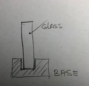

Hello Don. The idea is not to use glue at all! At some point, you want to open the case: just-in-case you may need a small repair or cleanup. You want to make a grove in the base so the glass case will go in. Take a look my sketch
KURT, I got mine at PETCO, THEY HAVE A LOT OF SELECTIONS THERE MORE IN THE STORE THE ONLINE, THEY HAD PLEXIGLASS ALSO BUT IN ODD SHAPES AN MUCH MORE EXPESIVE THEN THE GLASS I WILL SHOW A PICTURE ON WENSDAY AS I DO NOT WANT TO LIFT IT IT IS NOT THAT HEAVY BUT NOT ALLOWED TO LIFT IT HEALTH WISE, i am going to mount it on a piece of OAK Jim suggested to rote a grove a nd not use glue as this is a christmas gift i need glue it but not sure what kind of glue to use, also we can not find the router and my drmell roter will not worl=k on oak but i have thougt of another way to do this, but still did to use glue the trim is a hard plaastic piece so what type of glue to use, any help would be appreciated. THANKS Don

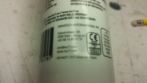

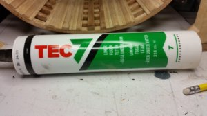

Tec 7.
This type of glue can glue just about anything. Just remember to degrease well with acetone before gluing. available in several colors.
If the glue is slightly inaccurate then you can straighten the edges with razor blades and soapy water.
Use masking tape to get nice edges.
It can certainly be purchased in the US.
