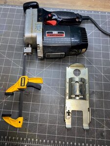

Hello all,
I got this idea from a video I watched on You Tube...I used an old Sears Craftsman Jig Saw and attached a clamp in place of a blade after reaming out the hole in the clamps arm to fit the screw on the saw that holds the blade in place (clamp now). I had to remove the guide pictured to the bottom right in the photo to allow for taller bottles of paint. This didn't cost me anything more than what I had already spent on the tools I had on hand. As I don't have a way to hold the paint in place as it is being mixed other than the pressure of the clamp, I cup may hand around the bottle as I am mixing it. The variable speed of the saw makes this work great...

Hello all,
... As I don't have a way to hold the paint in place as it is being mixed other than the pressure of the clamp, I cup may hand around the bottle as I am mixing it. The variable speed of the saw makes this work great...
Frank
Thanks, Frank,
Why not use a strip of Velcro or a wire tie that could be cut off??? At least that's what I'm doing. :)

I use my jig saw too with a 99 cent clamp from Harbor Freight. I had to file down the clamp as it was too wide for the blade mount and I use my jig saw so did not want to mess with the blade mounting. I used my Dremel to take a little metal off the end of the clamp and it goes in just like a blade does.
As suggested above, I use Velcro to hold the bottles of paint. I drilled the holes in the clamp using a blade as a guide.
That jig saw shakes the hell out of the paint. I have many bottles of old Testors and Model Master that were settled with all the carrier agent on top of the hardened paint. It takes only a minute and brings paint that would have been useless right back to life. Just make sure the lid is tight!
It is also good to store your paint upside down, the jars seem to seal better that way...again be sure the lids are tight!

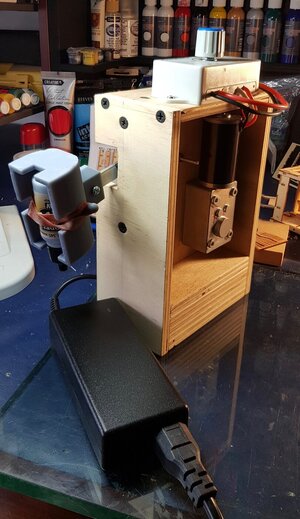

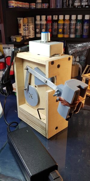

A while back I finished building the paint shaker as per the video I posted above.
I didn't have a camera then so I didn't capture the process but I'll post pictures now of the finished paint shaker.
Instead of having an on/off switch + a speed controller like in the video I combined them in a single unit.
I turned the 3D printed bottle holder upside down as that's the way I have always shaken paint bottles by hand- I found that the air pocket and bubbles rising to the top of the bottle releases the paint that settled on the bottom.
It took about one weekend in total to build (over several weekends while I waited for parts)- I added an extra heavy base so it wouldn't jump around like in the video.
It has worked flawlessly - the only problem is remembering to put the bottle in about 30 seconds to 1 minute before I need to use it.
