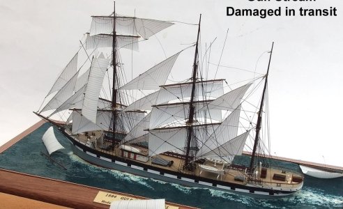

Good evening Bob. I've just been reading this thread and I'm wondering what happened to the Gulf Stream. I'm assuming that you shipped it to a customer and somehow it got wrecked. Maybe you would tell the story again. Also you have mentioned metal parts for sailing vessels and a lack of them being available. Maybe you should write a book about doing that sort of thing. I have needed parts like that myself and tried to make them using brass. They came out ok but are nothing to brag about. I'd like to know more about things like that.

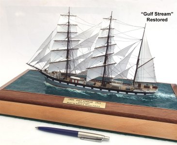

The Gulf Stream came back to me, and the courier dropped it again, and damaged it even more. I eventually re-rigged it and it is now in my permanent collection. I am now 81 and have stopped building models, mainly due to becoming allergic to glue fumes. I have never purchased metal parts for my models. I make everything myself. There was nothing inside sailing ships apart from either ballast or cargo, so nothing went on inside them at sea. The crew lived either in the forecastle, or a deckhouse behind the foremast. The captain and officers lived right aft inside the poop deck. The apprentices usually lived in a small deckhouse behind the mainmast.
I have written many thousands of words about miniature shipbuilding, and here is the complete catalogue of downloads, many of which are only the price of a cup of coffee. Plans of the Gulf Stream and full constructional details are among them (two separate downloads). Click any front page to read the synopsis of the contents. If you wish to purchase a download, a button is provided in the synpsis for Paypal or cards. I never built many clipperes, preferring the big heavy "windjammer" class of vessel. If you are in Facebook, I have a group called Merchant Ships in Miniature.

Robert...I'm so sorry she got so damaged. It frustrates me to no end when carriers simply fail at their job...to *Handle carefully*, *Fragile*...... to protect items they are told are extremely fragile.

Thank you Rob,
As you can see above, I put it all together again as good as new, but it was the last one I tried to sell. I am pretty washed up these days, aqd about all I can do is write and study. I can't even go out for pleasure these days, because I am out of breath after walking a few yards, but I can potter round the house fairly well.

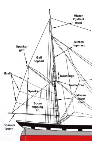

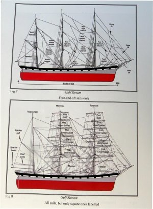

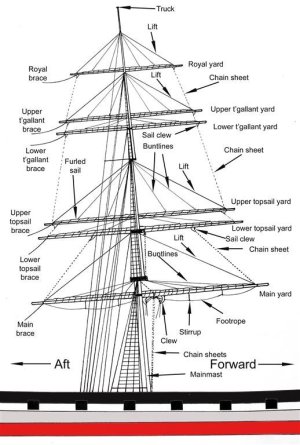

Thanks for replies. Please address questions to the forum rather than in private messages to me. The reason for this is that posts in the forum benefit everyone. Replying to privates messages individually is rather time-consuming for me, especially when they are concerning a particular model.

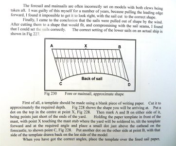

Here is a sail plan from the download naming the sails on the Gulf Stream. Also the shaping of a sail on an ostrich egg, and arriving at a shape that will fit correctly. I did not mention the lines on the sail because they could be applied to the paper any way you wish - a fine drawing pen, or even a hard pencil. I make them on the computer. No special programme is required for this, it can be done in normal word processing. Underlines, printed in grey so they are not too prominent.
I am not a computer expert, and each must find their own preferred method of producing the lines.
I think a lot of the problem is that an increasing number of people download these practicums into mobile phones, that to me, seem to a bit too small to use.
If you download to a desktop computer, and print from that, they will come out at A4 size, but as I said, I am no computer expert.
These models do not build themselves, and it is necessary to use the downloads as a guide.
