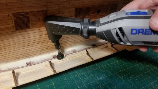

just from personal experience, I use my cordless 8200 far more than my old 395. With the handle attachment and 90 head its very versatile and accurate, even with 0.4 mm bits. The Chinese copies are best fore sanding etc. The small light "grinders" sold cheaply on line only seem to last a few months- IF your lucky.

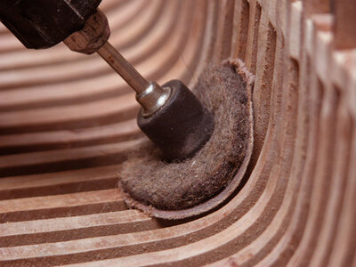

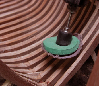

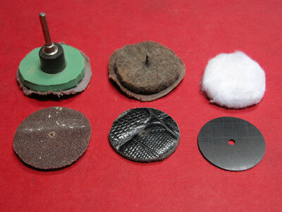

i also make my own accessories i save plastic bottle tops they make the best sanding disks and come in every size you can imagine.
With some of the softer materials i cut the sandpaper larges than the disk so it rides up along the edge

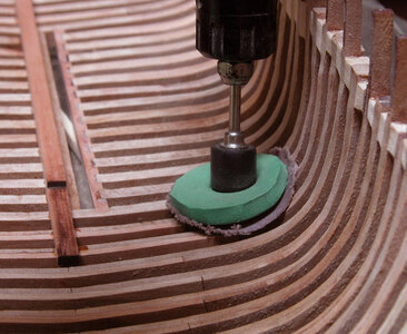

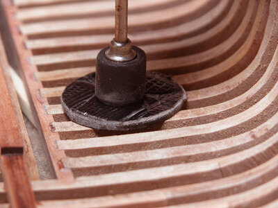

View attachment 253310View attachment 253311View attachment 253312View attachment 253313View attachment 253314

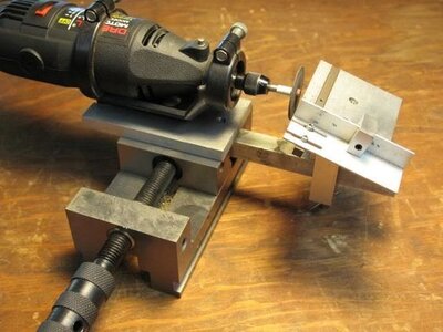

Dremel is not only for Shipbuilding. It is used by dentist, medical care, engraving id cristal. try to select what you need, and set the rest apart, because one day you may be needed.
Wow, thats a kool tool Alan.
I personally used an in making the Galleries -new windows frames, part to make looks better. I have used to try to engrave. and make figures
