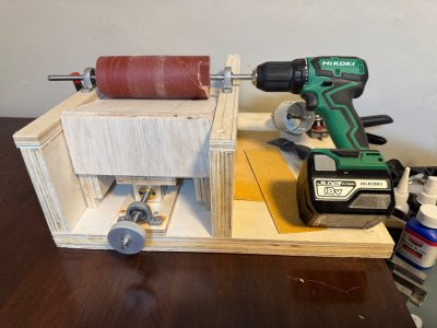

I have received most of the parts now and cut the plywood. Did you use the nut insert and machine screws to fasten the ball bearings and normal wood screws for the rest?I work between 3000-5000 RPM
Yes. The parts that you have to release now and then. Like the bearings.I have received most of the parts now and cut the plywood. Did you use the nut insert and machine screws to fasten the ball bearings and normal wood screws for the rest?
That's the difficult part. Make sure everything is lined up correct. This will give you advantage in the future.Dry fitting the rest of the parts.
Yes. I need a break now before the final assembly. I am not super happy with the height difference between left and right side. If I start raising one side then it will no longer be parallel with the top plate (F). I will see where I stand after creating the drum.That's the difficult part. Make sure everything is lined up correct. This will give you advantage in the future.

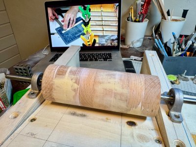

No Idea, I used for the drum hardwood. And when the wood changes it wil do it over the lenght. So you will never novice in your result. Because you sand and measure till your result is goodGreat design. I'm looking to sand rather thin material reliably. Frequently down to 0.4mm. I've always wondered, do these wooden drums become distorted from humidity changes?
Thanks. It is also stable, because the sled will always be straight to the drum. I had to sold mine, because someone needed one. But there are plans to build a new one in the future.I guess any minor inconsistencies are averaged out by the rotation. I've been wanting to turn my spindle sander into a thicknesser for some time and your design is the best I've seen for making adjustment.

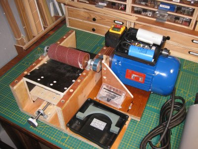

I go by the rule: 1700 RPM max - too fast and there could be char.What is a good RPM for the sanding drum?
And it will cover EVERYTHING in the environment - especially if the grit is 220-240.A dust cover/suction is a luxury you will need. The very fine dust that comes from the machine will give you bad lungs
