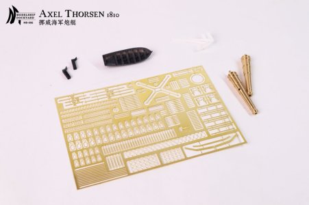

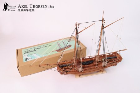

Hello folks
New Kit from Modelship Dockyard
Axel Thorsen 1810 Dane - Norwegian Schooner 1:72​
