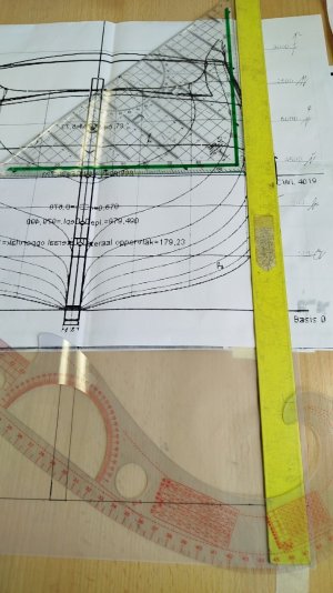

Today tryed to refine the "inner lines" of the bulkheads and run straight into the question "Where does the line runs?" so I am really unshure where to place this important line...
...the hull's lines ends and there is no idea given to the bulkwalk been placed. Is there any helpfull hint to this quest?
Here my method to a line of dots pointed by the set square to it's 5mms point - than drawings short parallel lines becoming the parallel to the bent curved of the decks' top.
Also the WL-slots are constructed coloured in bright yellow wax pen to find them easily...

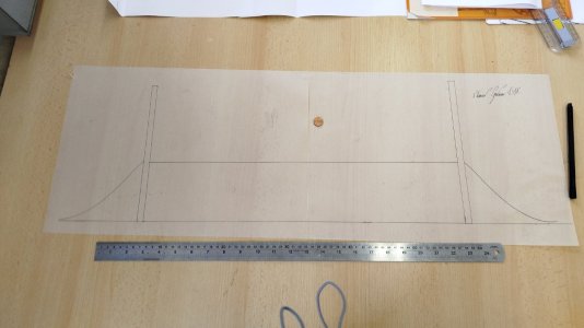

Starting with collecting some ideas for the stand - a semiregular pattern on a lattice gritt is getting born. Just rough doodlings:
The cote of arms of Amsterdam with a golden frame becoming gradiendly a lattice with the field bindweed the pink of the floewrs is only due to my bad eyesight.
I got the horrible idea to go down a heavy three dimensional path with the Amsterdam's cote of arms. For the other side I will add the Amsterdam's admirality cote of arms with twoncrossing anchors on a yellow (or golden????) field.
The Stand (from 10mm beech plywood)
The stand is to build twice a working and a decor stand.

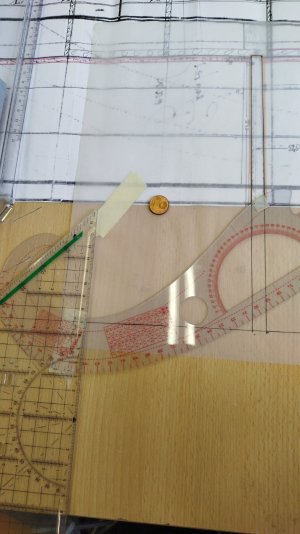

Certainly it has to avoid any stamping to port and starboard so I added two parts to shore up. These parts will be decor-cladded so I gave them an elegant (hopefully) light curve using a tailor's ruler - marking the endpoints by tape.

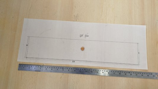

The nameplate is aft lightly shorter than on the stem side (0,5° fall of the keel).
I made a seperate drawing for the nameplate to copy it today and doodling on the weekend...
