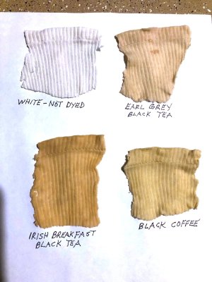

Ok, found an old sleeveless t-shirt (some call it a w*** beater shirt). Cut up small sections, brewed some Twining's Black Tea (Earl Grey & Irish Breakfast) and brew a cup of black coffee from my Keurig K-Cup machine. Let the tea bags steep for around 10 minutes, wetted the pieces and let them soak in each cup for around five minutes. Took them out and gave them all a good rinse and laid them on a paper towel for a bit.
The coffee one came out a nice dark, but when I rinsed it all washed away and was rather light in tone. The teas kept their tones after a rinse, so I'll go with the tea method.
The Earl Grey was a little too light for my liking, but the Irish has a very nice darkened tone to it, so I'll be using that one. Glad I did those tests beforehand.
The picture makes them look darker than they are. Just my limited photo skills with my phones camera. IMG_0443.JPG
The black coffee sample looks the most like the color of used sail cloth, but as colors appear darker at a distance (an adjustment appropriate in terms of paint colors as well,) I'd say go with the Irish Breakfast Black Tea result. That's also the color of quite old cotton or linen sails on ship models I've restored, so you can expect your model to have a bit of a "vintage" look, I expect.

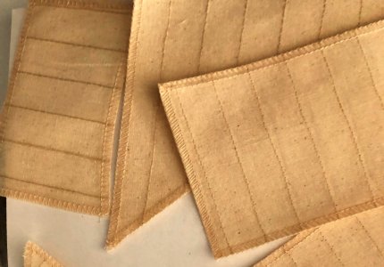

Well, I went to Hobby Lobby and a lady gave me a scrap white cotton and also guided me on what RIT dye to use. It was Neutral-2 but the lady said it comes out like a khaki shade. I mixed up a bit with water to get it close to the tea that looked nice. Looked pretty good on the scrap and with fingers crossed, I dyed all the sales. Came out just about perfect. Whew! I needed a bourbon after that. Goes really well with the oak, maple and walnut stains of the ships wood.
The scrap looked like it was pillow case fabric and have no idea the thread count. The sails do look a bit large from the boxes picture, but I'll use them anyway. I have no idea how to sew and don't even have a sewing machine. I'm good with them. Maybe next ship.
