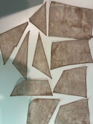

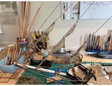

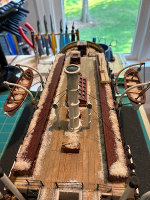

I'm going with the silkspan! I like the weight, I like the color, just very delicate so I have to be careful. I also painted a piece of silkspan in oils which I am not using for the sails but will use for other accessories that would be covered in canvas.

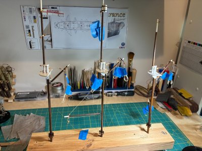

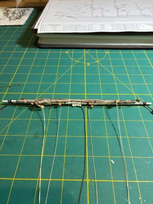

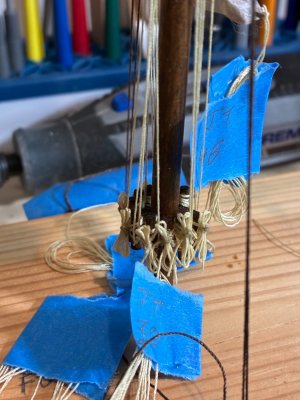

You can see the difference here. I fortified the sails with a strip of silkspan on all sides and front and back, and also fortified the corners where the lines will attach.

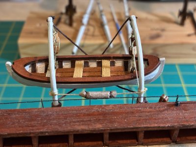

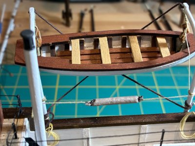

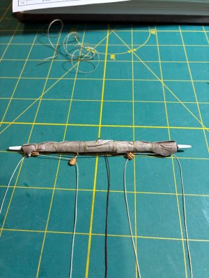

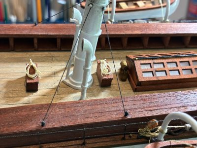

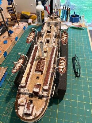

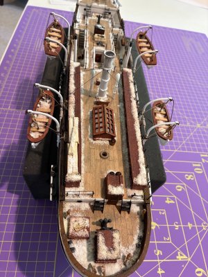

Below, I used the silkspan for the bumpers for the ship's boats. It's pretty easy to work with. First you dampen the fabric to make it more pliable, then when applying I painted on some thinned out Titebond glue.

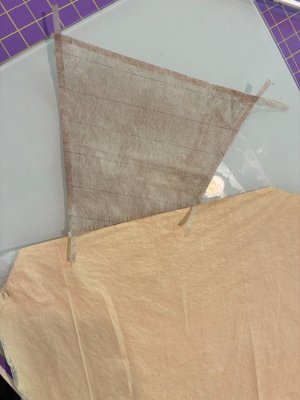

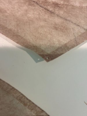

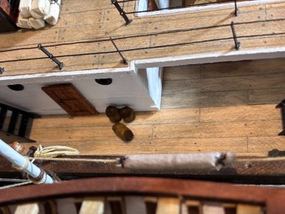

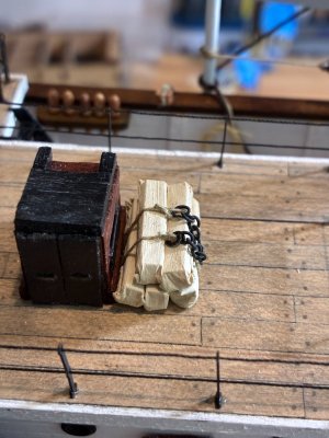

And here's the oil-painted silkspan. I used it for the canvas screen on the stern.

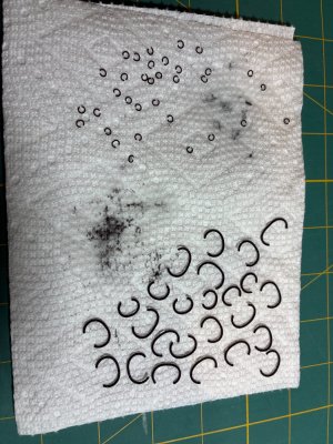

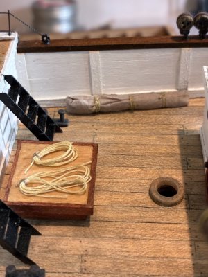

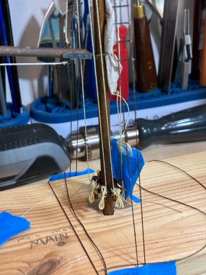

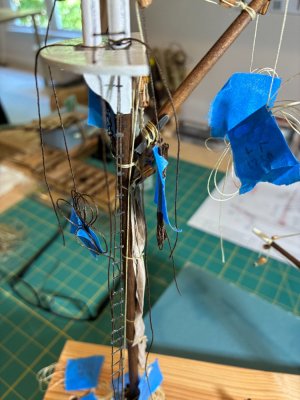

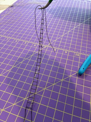

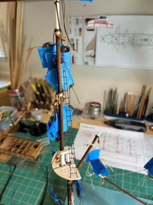

I'm working on the rigging now. It's going good, I'll post some pictures at the end of the long weekend. But planning ahead, I'm trying to figure out what to do about the ratlines. OcCre says to use thread, but the ship had round, wooden ratlines. I don't think I'll find wood cut that thin to make it look more to scale. I was thinking of using wire and blackening it. Then I had a thought...staples! I'm going to experiment, but I'm thinking staples attached to a board, then glue the line to the staples. I can then paint the ratlines brown or black and cut them off the board with cutters. This will take some planning and experimentation.
