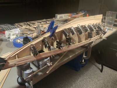

Thanks for the advice Clair...the videos OcCre provides for the Polaris show them using Contact Cement for the deck and the second layer of planks. I could see using Wood Glue in its place but am at a loss as to how to clamp the planks to the deck and the second layer of planks to the sides.
Probably way to late for this post but I saw a video that used binder clips to hold planks. You take the clip from one and insert it into the other. Here’s a pic of using them. D2ADD038-F20F-4F5B-8184-EBFC8F1ADDE0.jpeg

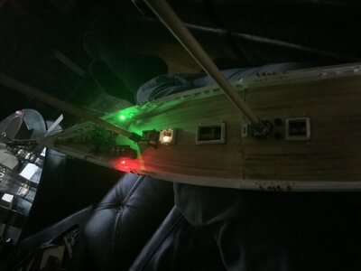

I would eventually like to add lights to a ship but with my first, I'm not sure if I want to attempt that one...lol
Lights are awesome, I found “pico” led (1mm) lights on Amazon, that come with built in resistors. I used a 3 AA battery pack with an on/off switch under the cabin. I have 5 white, 1 green & 1 red on my bluenose I’m building now. Here’s a pic with a view of the foredeck. Lights will be installed in the shrouds when ready. The wire is just recycled Ethernet (network) cable, use solid core wire not the stranded stuff. The lights are bright but small enough to fit in the fake lanterns, just drilled up into them with a 1 mm bit and filed some slots into the face for the light to be seen.2393601C-6B93-4304-8AC3-2CDC172F8CD4.jpeg
