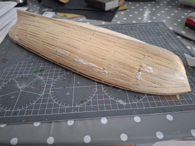

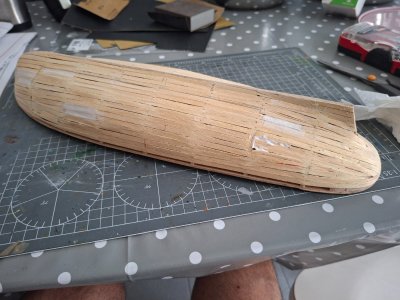

this is my first layer of planks, I started to sand it (overdid) before using some putty and more sanding. I'm not sure I'll get an smooth enough surface for the second layer of planks. any advice, thx!!
As Allen posted at this point what are your final plans for the hull because that will make a difference in how you go forward. I would use a wood filler or putty and coat the entire hull with a thin layer then sand the hull as best you can. you need a smooth surface in order for the second planking to look good. You may need to add putty if you get a low spot.

It looks to me like you have done a very good job of sheathing over the molds -given what you had to work with.
You were betrayed / sabotaged from the start:
You needed at least twice the number of molds than this kit provided.
You needed for layer one: a wood species that has more spring - is stiffer - a species that does not dip between the too far apart molds.
You needed planks that are thick enough to be shaved thinner in places.
You also needed first layer wood planking that is wide enough to spill (OK -spile - Cockney for spoil -i.e. wasting wood from wide plank to make it more narrow so as to fit.) But NO kit provides this.
For the dips - you need wood scabs. If you are a woodworker this is easy, A wood curl from a Pine plank done by an "air molecule splitting sharp" plane blade. A thin veneer of wood that costs nothing - if you have the tools. If you are a kitchen table kit builder without a woodworkers garage full of tools, you may have to find someone who does.
PVA bonding scabs of veneer over the dips can get you the needed smooth run.
Thin gaps between layer one planks are OK. Open or filled - this has no effect on layer two planking.
I advise that you get angry and determined to see this thru. The kit design may be far from adequate but "Illegitimi non carborundum." Joe Stilwell

There’s nothing magic about double planking the hull. It doesn’t have any relationship to how an actual ship was built. It’s just the kit manufacturers system for getting a hull that more or less matches the lines of the real ship’s hull. This is a case where Bondo or a Bondo like putty is your friend. Trowel it on, let it cure and sand it down until you get a smooth surface.
I suggest Durham’s Rock Hard Water Putty.
You are doing it correctly. This stage milestone will be to get a perfect shaped hull. Sand and ad putting/ wood filler as needed. Do that until you get the correct hull shape. It isn't difficult at all, besides that you will have do a lot of sanding.
I think that was the simple answer you were looking for.
Then, after you have a perfect hull shape, do your second planking as suggested by the kit or, do it as it was suggested by many of the experts that posted before me. Is it up to you, on this learning face, if you want to do your first double planked kit "easy as suggested in the kit" or more professional. Just enjoy the built !!!!.
Cheers
Daniel
Ps: add putting/wood filler without being afraid of overdoing. Just ad, dry, sand .... continue until you get that perfect shape.
