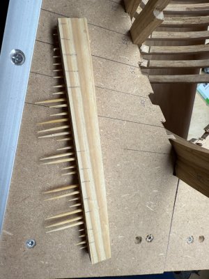

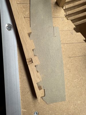

Hie Frank,

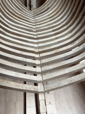

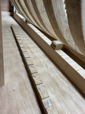

The distance of the notches are determined by the distance between the rafters and is discribed in the book. The same technique was used in the past on the real ships.

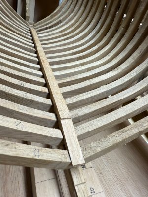

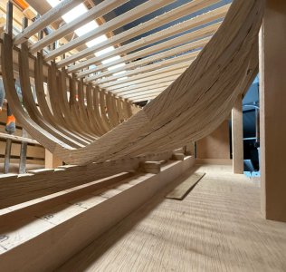

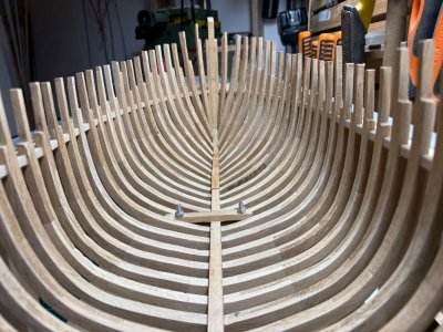

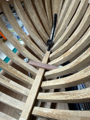

Nice preparations, Rob. She is showing her lines more and more.The beams are shapened on the right height:
To determine the right line of the upper parts of the beams I placed a small and thin stroke of wood. In this way it is possible to assess it properly the right line of the ship.

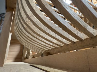

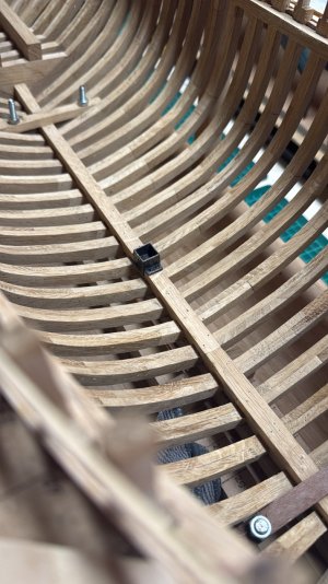

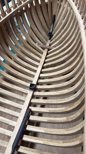

I have made the foundation for the engine.
In the early days the engine was in the middle of the ship, this is a model of the replica of this ship. On the replica the engine is in the back.

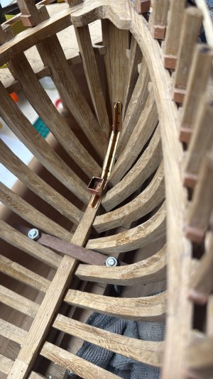

In the meantime I have placed the reinforcements for the bow as in the original ship. I have made this in brass and chemical colored them. Also the base for the masts are ready.
