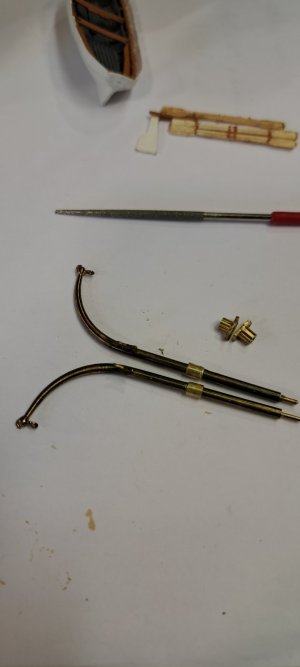

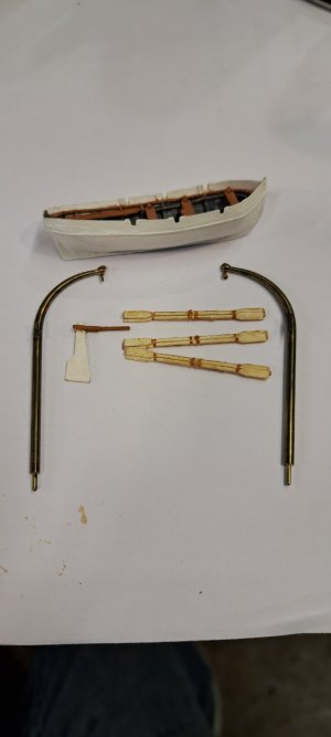

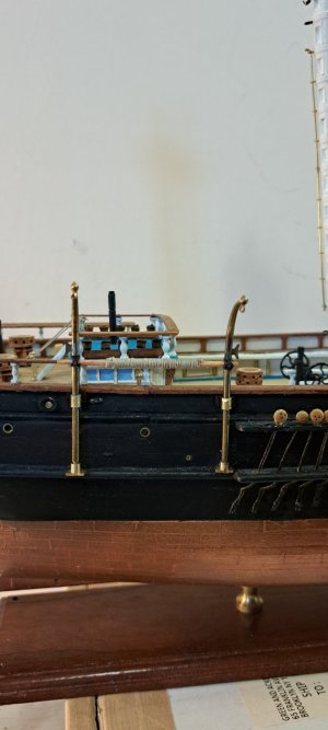

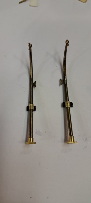

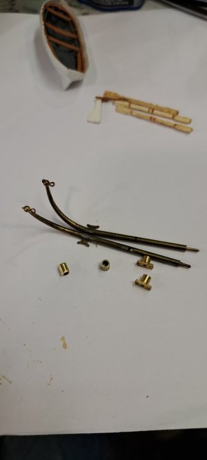

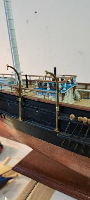

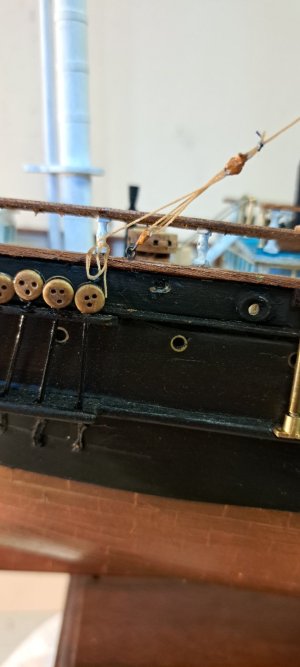

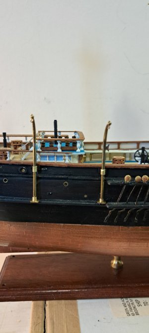

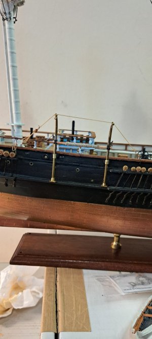

I found some nice brass davits in my stash complete with cleats and foot brackets. I made support brackets out of brass tubing with wood support blocks.
These are now fixed in place. Eyebolts for the boat skids on the deckhouse and attaching the three boats there as well as fitting out the quarter boat davits and rigging them are next. Then fitting out the Quarter boat and hanging it from the davits. I will display that boat open with all the oar bundles, mast and furled sail inside. I'll show the rudder mounted.20250509_115920.jpg20250509_123244.jpg20250509_124006.jpg20250509_131024.jpg20250509_131557.jpg20250509_131626.jpg

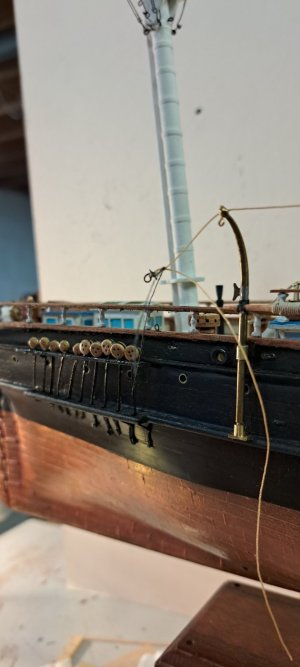

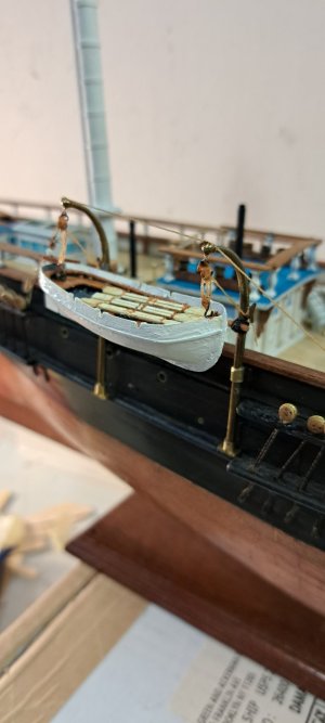

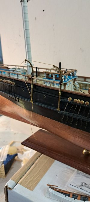

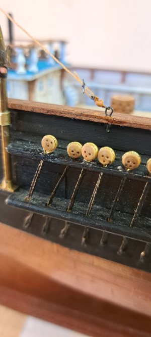

Rigging The davits. Fitting out the boat.

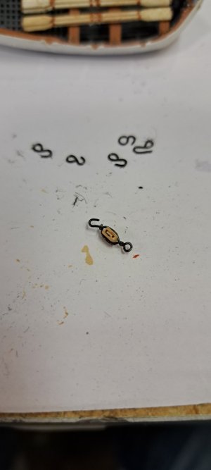

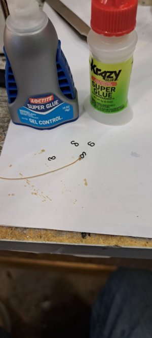

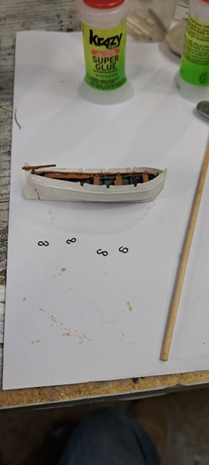

I stropped a 1/8' block but decided that the whole thing was out of scale at 3-4 feet, I decided to make the blocks out ou splitrings with the hook as one piece. The whole thing can be rigged and the "block filled in with a drop of CA gel and then painted. Closer to scale and easier to fabricate at this tiny size.

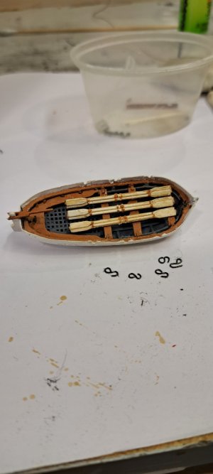

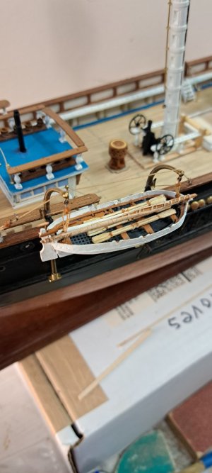

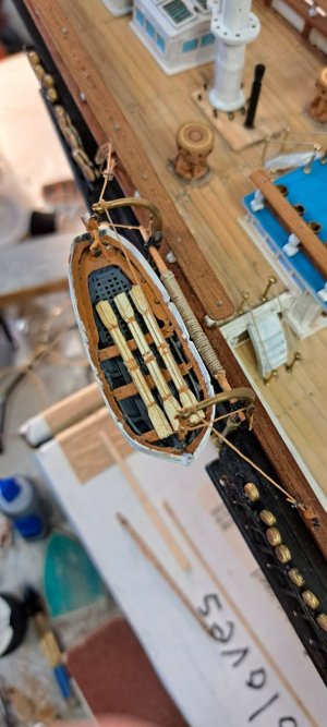

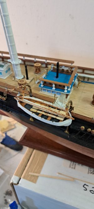

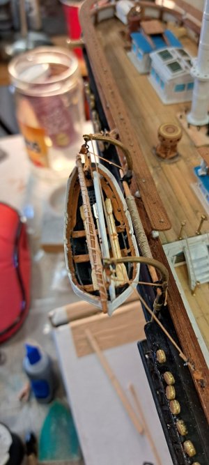

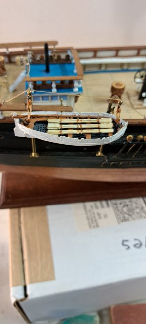

Quarter boat to be mounted next.20250513_132214.jpg20250512_131205.jpg20250512_132832.jpg20250512_132808.jpg20250513_123719.jpg20250513_125703.jpg20250513_125645.jpg20250513_125558.jpg20250513_124148.jpg20250513_123750.jpg20250513_130250.jpg20250513_131315.jpg
Question to all clipper aficionados. Would the Quarter boat have been equipped with a mast and sail? If so, gaff rigged? :confused:
Yes, quarter boats (often used as workboats or lifeboats stored on the quarters of larger ships, including clippers) were typically equipped with masts and sails, especially on long voyages where self-rescue and general utility were practical concerns.
If you’re detailing a quarter boat for a clipper, adding a small gaff rig would not be out of place at all; in fact, it would be historically reasonable and quite authentic. A single gaff rig (like a small yawl or sloop) was quite common, depending on the boat’s size and intended use.

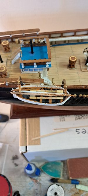

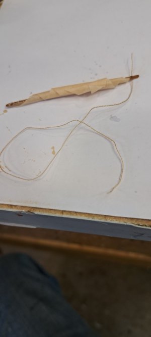

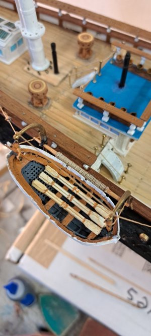

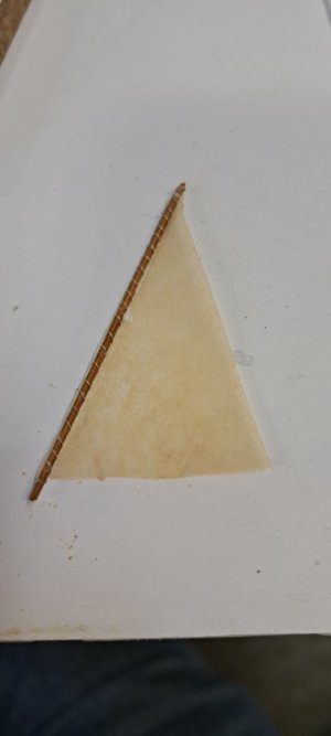

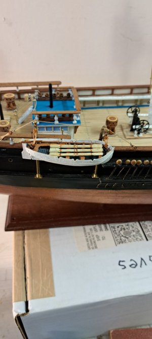

I installed the mast and lateen yard with a furled sail in the Quarter boat. I thought a lateen rig would give the most sail area for the least rigging and simplicity of handling for such a small boat. No barrel yet, but it would be a nice touch. The sail is Shoebox tissue. Save for the barrel that finishes the Quarter boat, davits and rig.

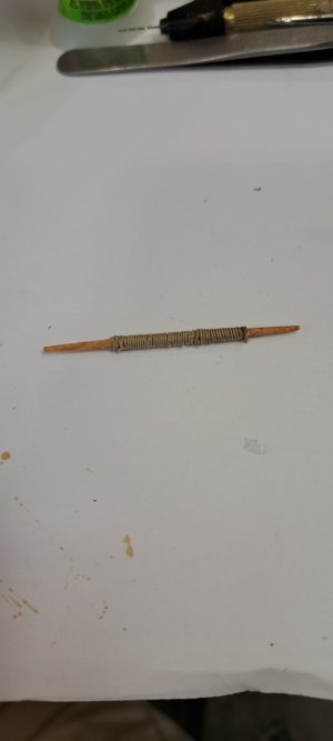

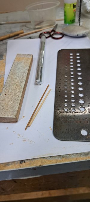

Shown is a steel drill guide used as a draw plate.20250515_145638.jpg20250515_150709.jpg20250515_153101.jpg20250515_153158.jpg20250515_153147.jpg20250515_153243.jpg
