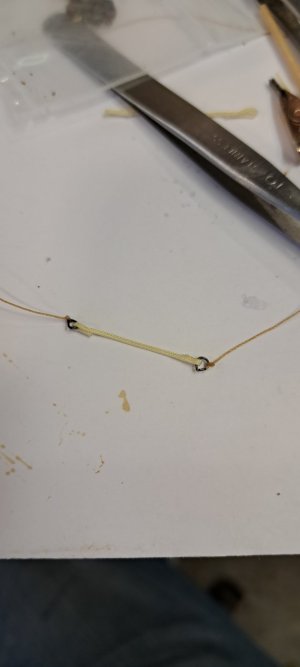

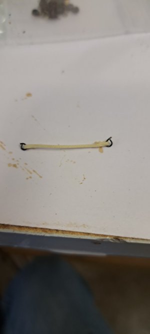

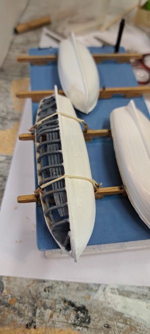

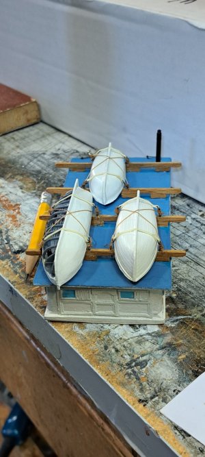

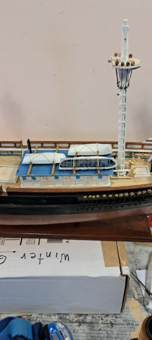

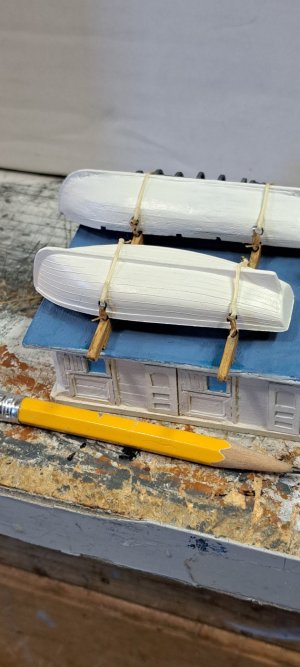

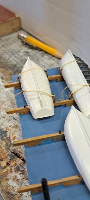

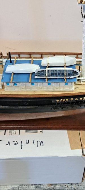

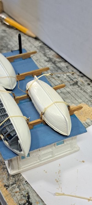

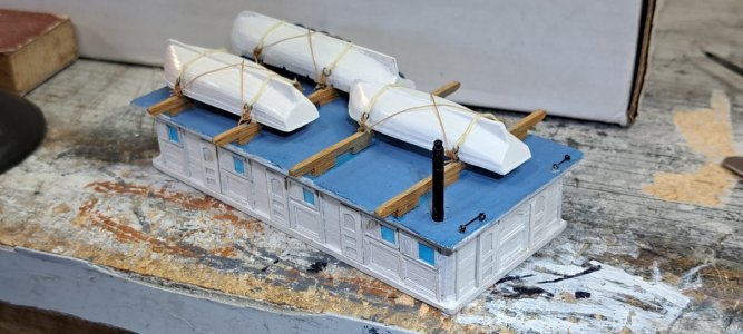

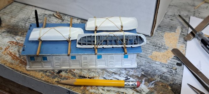

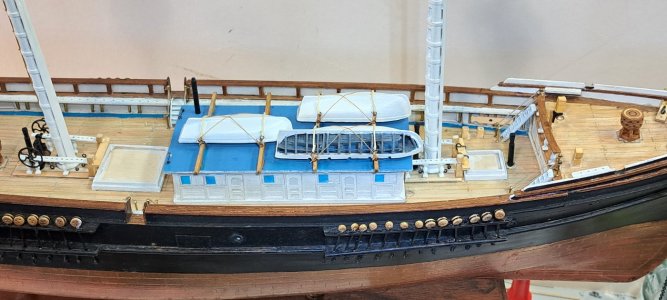

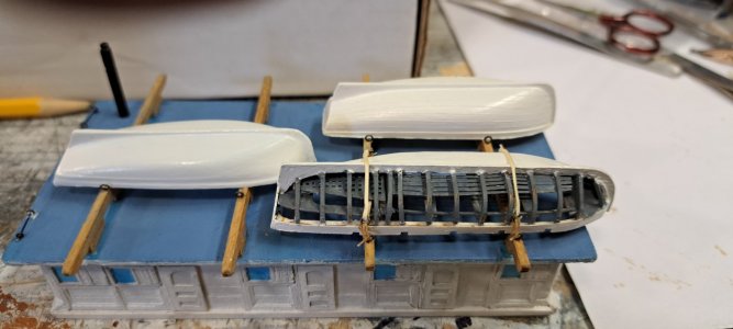

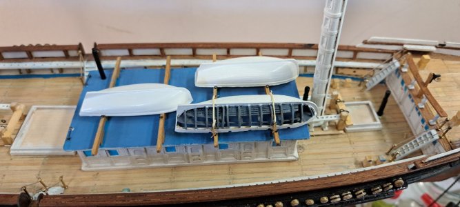

I've started mounting the ship's boats on the skids on the Deckhouse. I made split rings and fixed them into loops at either end of pieces of nylon fly fishing line that nicely approximates the fairly wide straps that hold the boats in place they are then tied down with "rope through the eyes at the ends of the straps and the eyebolts in the skids. Takes awhile to make all the parts and is very fiddley to tie off. Four more to straps go.20250518_112002.jpg 20250518_115853.jpg20250518_120957.jpg20250518_121206.jpg20250518_121459.jpg
Pete! One of my favorite things about your work, and there are many, is your creativity and audacity with materials that cause the eye to see in scale what it looked like. Here, again, nylon fishing line used to tell the eye to see wide straps. I looks just perfect, my friend!
Blessings. Peace. Gratitude.
Chuck

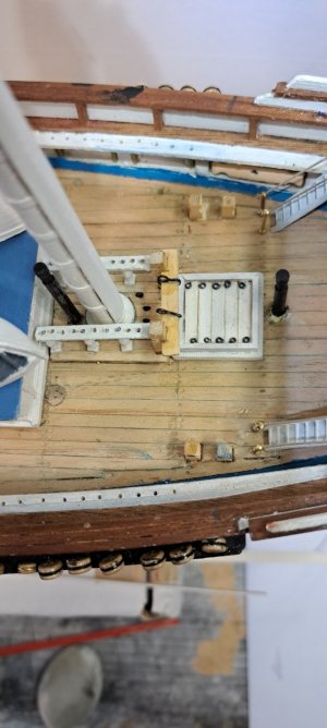

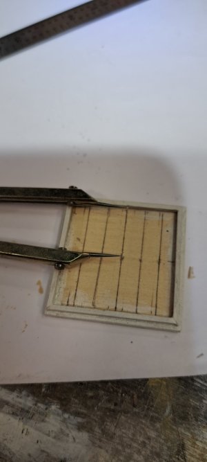

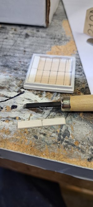

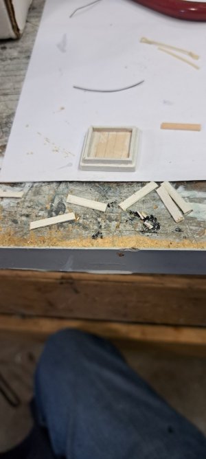

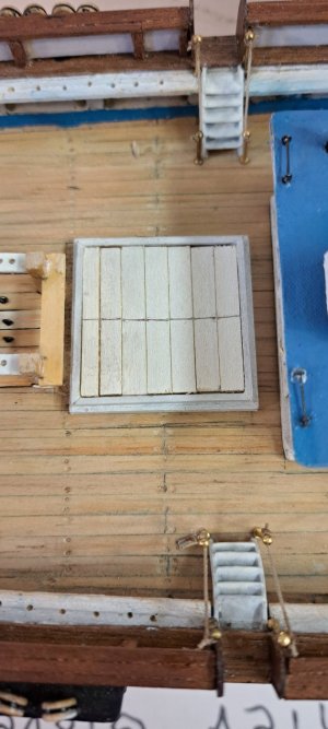

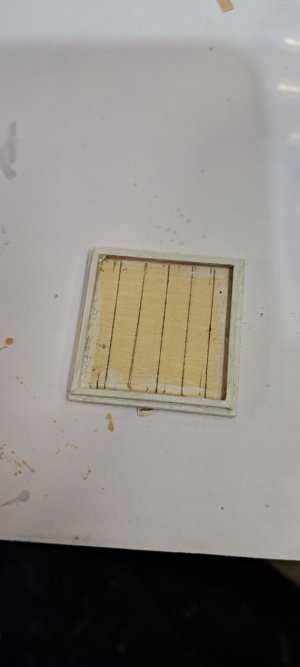

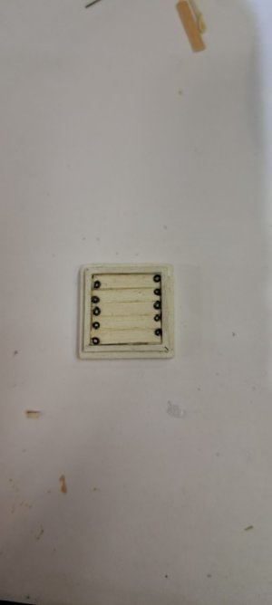

Working on the hatches. The larger one will be partially covered by a tarp folded back. The forward hatch will probably have a livestock pen over it, which looks like fun to make and a nice detail. But I still felt compelled to make what lies beneath. Both are still dry fitted. I don't like to lock the door behind my until I can rest assured that I won't have to go back in.20250521_140236.jpg20250521_141451.jpg20250521_135312.jpg20250521_144107.jpg20250521_144200.jpg20250521_144250.jpg20250521_144838.jpg20250522_114442.jpg20250522_113941.jpg20250522_120820.jpg20250523_122729.jpg:oops:

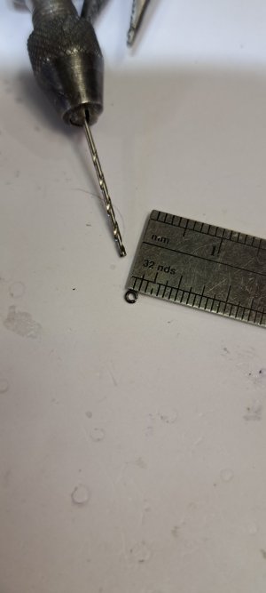

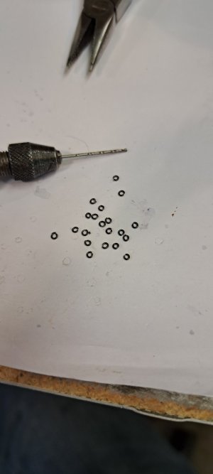

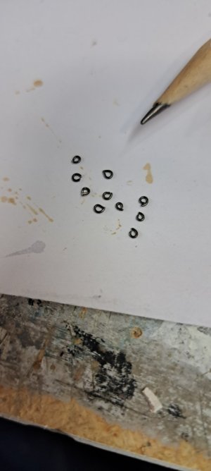

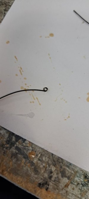

Peter, I don’t mean that making rings individually is the wrong approach at all. Some time ago, I put together a tutorial on making eyebolts and rings (Part 2), and you might find it interesting. With a bit of practice :) , this method lets you make dozens of rings in just a few minutes. What do you think?

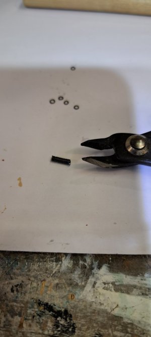

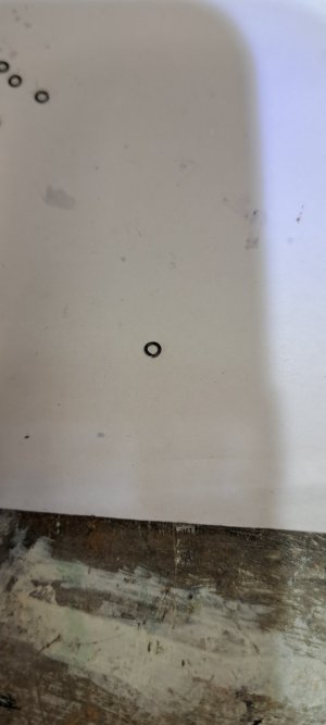

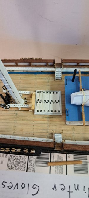

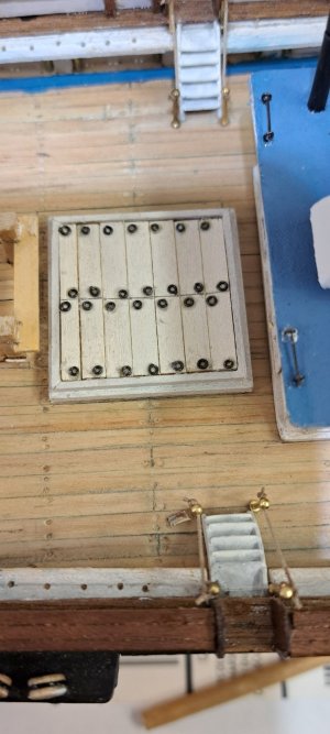

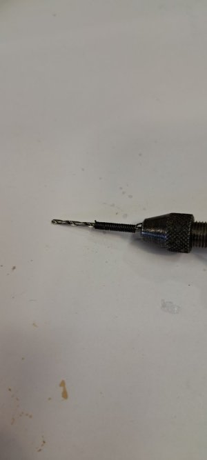

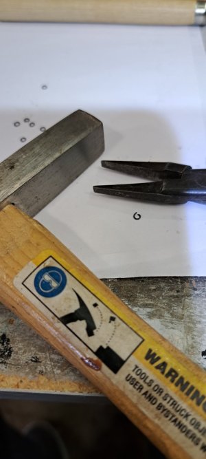

I remade most of the rings on the main hatch. At 1/8" =1' 1/16" scale. Ring diameter is 1/16"=6", pretty tiny to employ the entire Jimsky technique. I did wind the wire around a drill bit (slightly smaller diameter as the rings expand when cut). I used wire nippers to cut the rings (too small for a saw and dowel). If I had used brass wire I would have used a single edged razor blade to cut between the coils, but the annealed steel wire is too hard for a razorblade. The nippers cause some distortion, but I flattened the rings with a tack hammer. and closed the gap with flat nosed pliers.
I'm leaving the forward hatch as is because I will probably make an animal pen that mounts over top of it.
Thanks for the bump alongside to steer me into better waters.;)
Pete20250524_154520.jpg20250524_160045.jpg20250524_160251.jpg20250526_115403.jpg20250524_160452.jpg20250526_121951.jpg20250526_122243.jpgOf course this only represents the one go 'round that succeeded (well enough to declare victory). Not the three or so initial attempts).:rolleyes:
